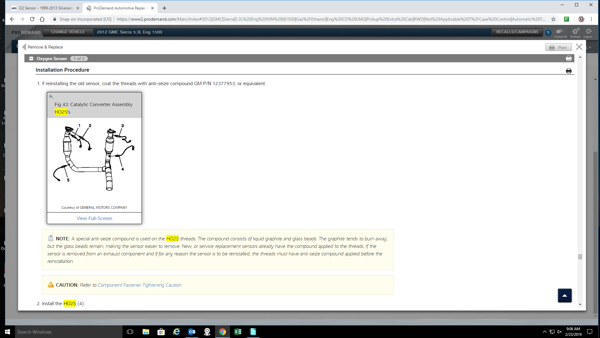

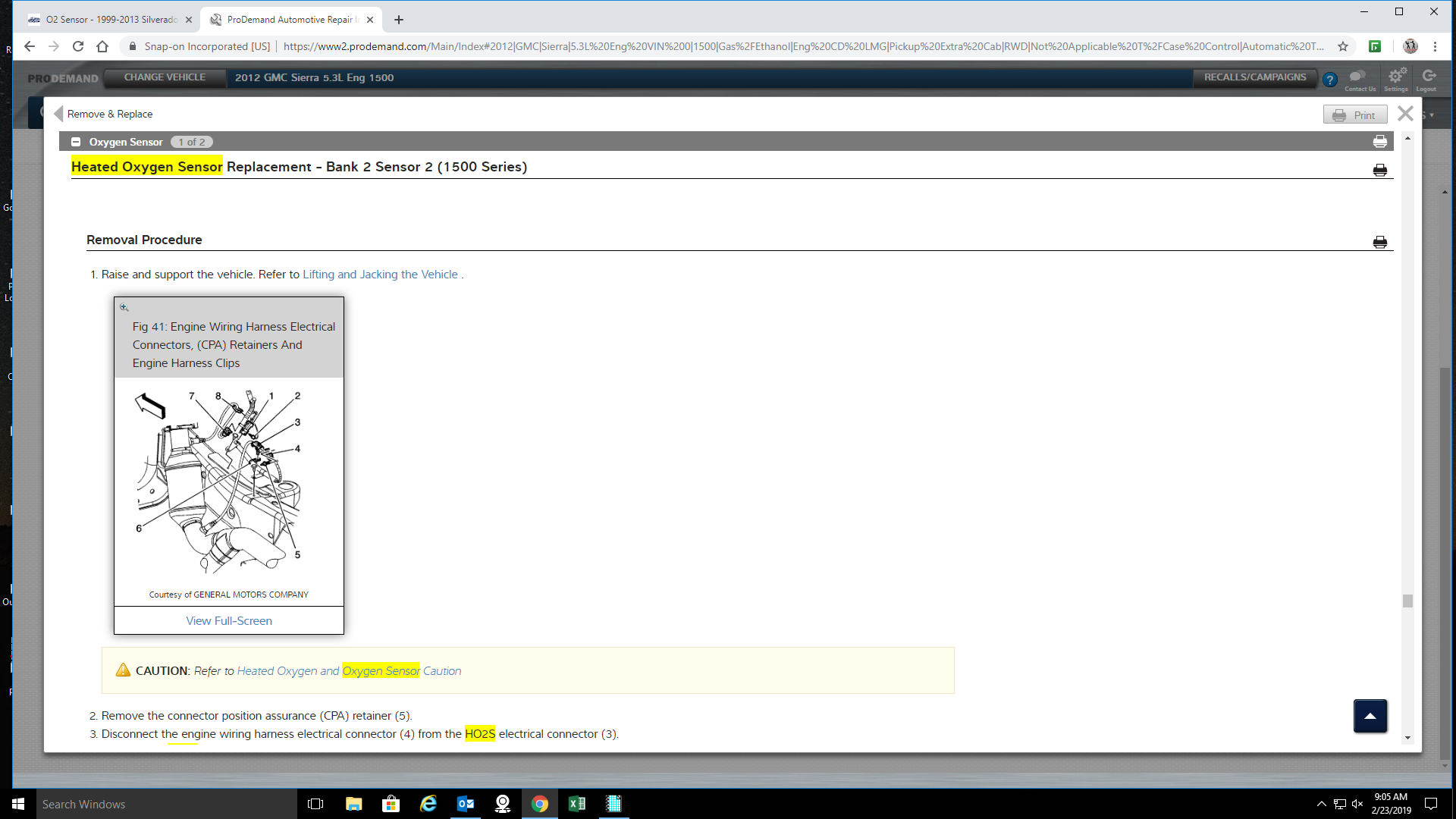

My engine light came on and I ran it through a computer and it is saying bank 2 sensor 2 02 sensor.
I believe that is the passenger side downstream sensor but I’m not sure and am having trouble finding a diagram.
Any help would be appreciated.
