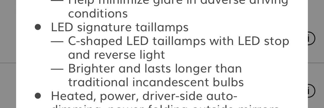

I saw this on the GMC site and assumed they were incandescent..
That’s for the SLE. SLT/AT4/Denali have LED everything except plate lights.
That's good news.. I'm glad I didn't dig too deep into it.. The tail lights came off rather easily with just 2 screws and a slight tug..
