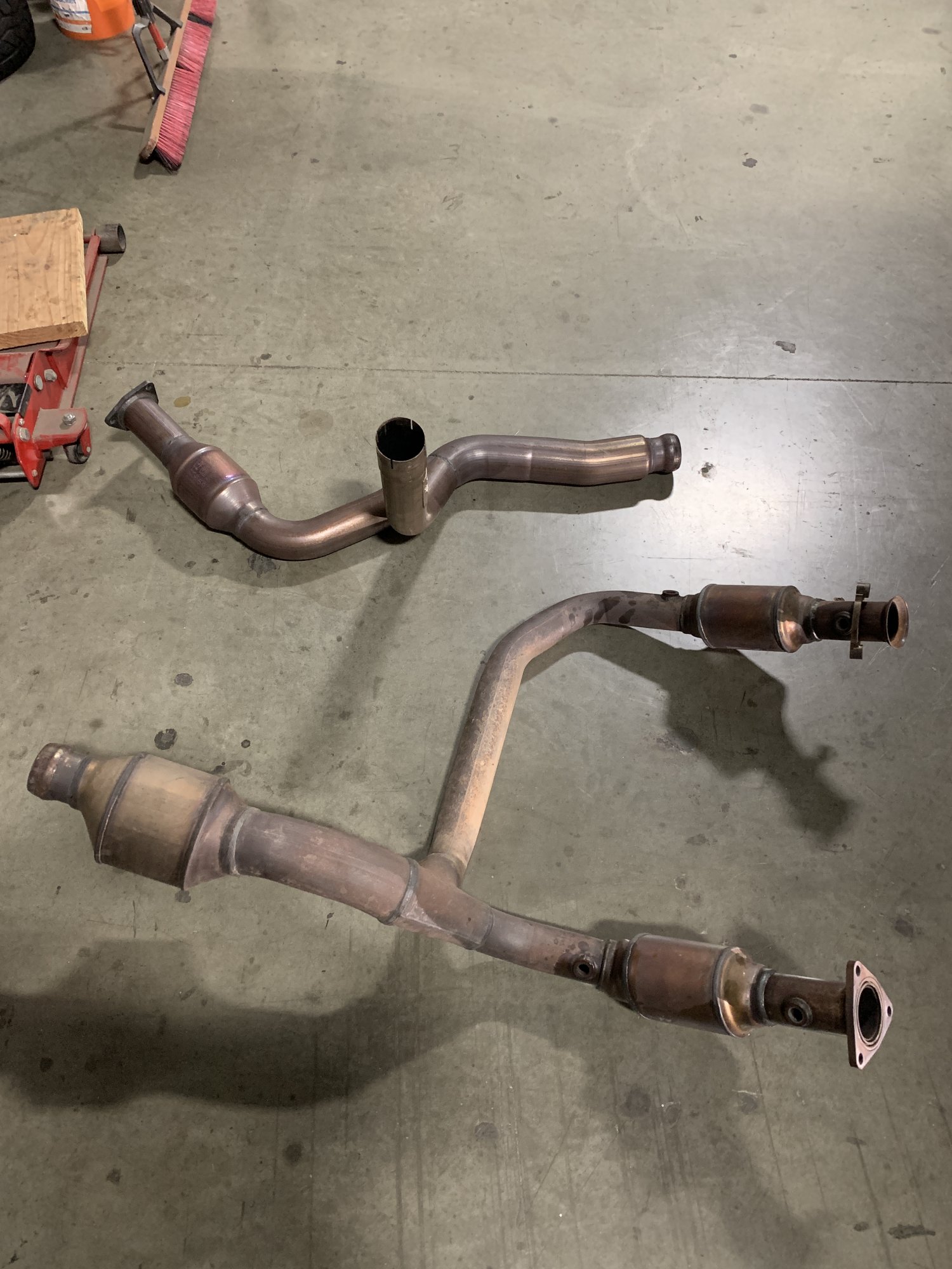

Going to be install my AFE Y-Pipe tonight using my buddies lift. I will take some pics and some sound clips as well Be on the look out.
Part number is 48-44004 if anyone is curious!
Got the pipes in! Truck sounds nasty. Install wasn’t terrible. I used a lift so that helped. Remove cross member/trans mount. Tons of room.

Factory manifolds. I live in CA so I didn't opt for long tube headers. This Y pipe still has 2 high flow cats but the main thing is the diameter of the piping is 3 inch all the way through. Not pinched like factory.

Assume this is for a 5.3? is there any gain in diameter? Also the AFE y-pipe is the one on top?
Yes i installed on my 5.3l   3 inch diameter then to 3.5 at the end. Yes the AFE is pictured in the top of the photo, one half of the AFE pipe, as its a two piece design.
