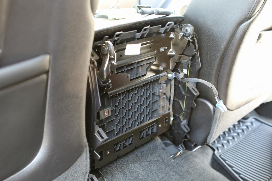

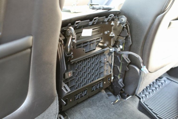

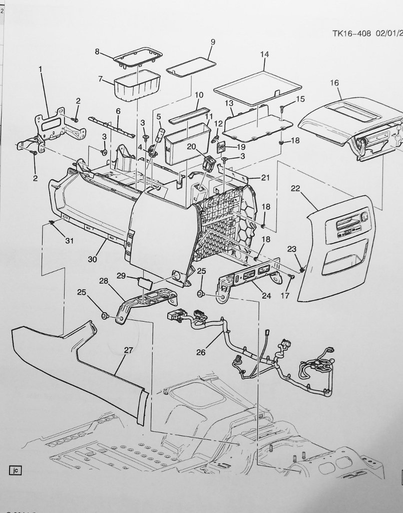

..I want to access the area behind the rear trim panel on my centre console.. maybe those that have done the console swap can help me with how to remove the rear trim panel?.. I am hoping it is not attached from the inside and I won't have to pull the entire console.. any exploded view parts listings I have seen only show these individually and not how they attach.. I've tried searching the console swap threads for pics but came up empty.
T15 screws are hidden in the rear peice. I think theres 4 of them
..  I did find the screws in the cubby area and removed them but I wasnt able to remove the rear trim panel ..I even tried some force with a trim tool but still it holds on.. am I missing something?
Edited by STRMTRPR
There is 2 more same area. I just dont quite remember where theyre at
Sent from my SM-G955U using Tapatalk
  • Thanks 1
.. awesome.. thanks for the help Nasty :thumbs:.. the other 2 were above them at the very top of the cubby
.. there were a total of 4...2 behind the rubber insert and 2 directly above the first pair at the very top of the cubby

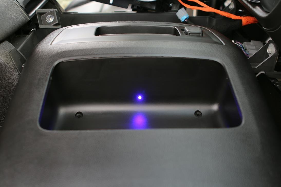

i know i'm a little late to the party....but for others wanting some pics....
i added a little LED to the back cubby.....
  • Like 3
..LOL that's awesome.. that's exactly what I did as well to both the upper and lower cubby.. I just tapped power from the socket
