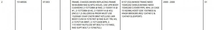

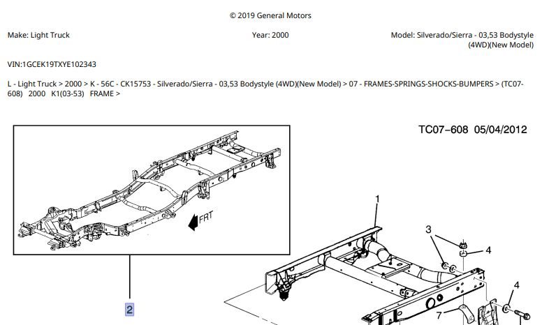

Here you go. Sorry had to wait till I could get back to work to get you this information.
  • Thanks 1
Thanks for taking the time to look that up and post it, I couldn't find it anywhere! Now I can get back to shopping for a frame. Just to be clear and make sure I'm reading that right, my frame uses the 40.8mm body mounting holes?
Yes sir.
