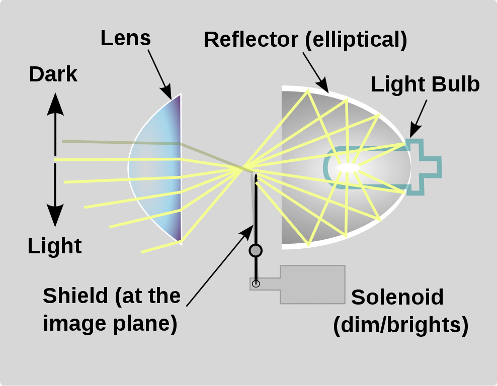

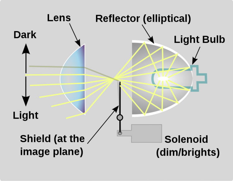

The Sierra's with projector lights like mine don't have a separate high and low beam. When you turn on the highs a solenoid opens a shutter to create the high beam pattern. Flashing the highs won't affect the HIDs at all.

It has projector housings. I didn't get a pic of it but the cutoff line is super sharp and clean
