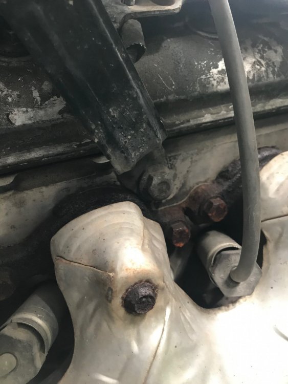

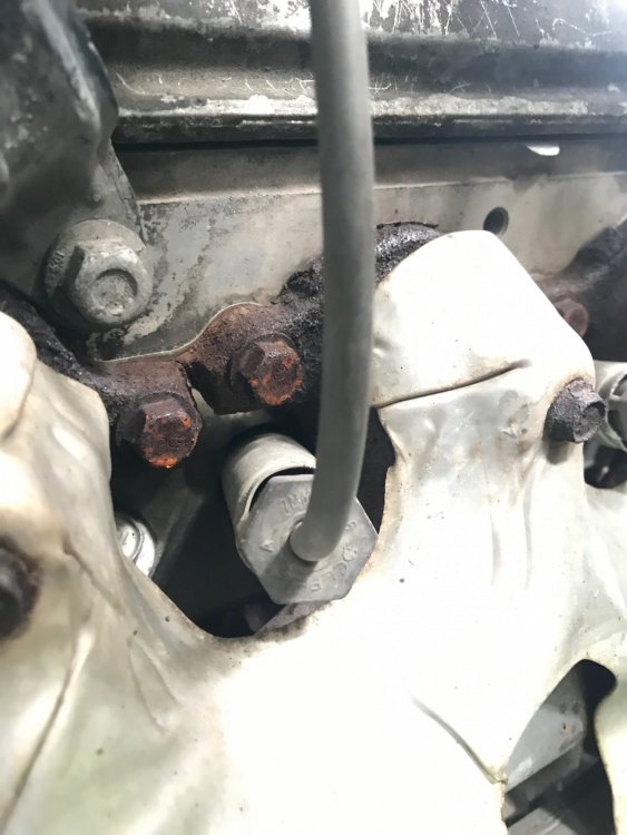

IMG_2929.thumb.jpg.29344cc73b574bc62d550390ba2f5bda.jpgHey guys, just noticed on the passenger side what looks like a crack in the exhaust manifold. It doesnt sound like there is a leak and all of the bolts are intact. Thoughts? IMG_2928.thumb.jpg.b35a4ed9a3e0b1b832796bc72f43823c.jpg
Not a problem, they are supposed to break there!  Allows for heat expansion.  Many of the newer 6.0L manifolds are saw cut in the same spot between the 3rd. and 4th. bolt.
