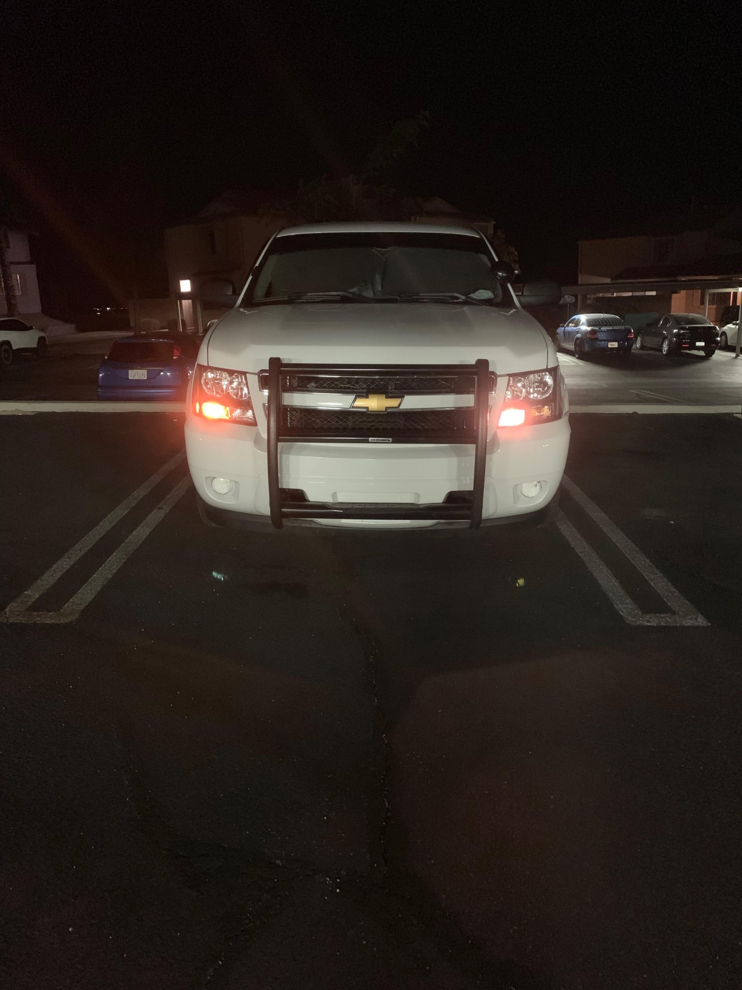

So after a minor collision causing me to replace most of the front end cosmetics of my tahoe, I've had an issue with my headlights ever since. Never had this issue before. At night, ONE DRL will stay on. That headlights park light will not work on that headlight unlike the other. Checked all bulbs and none are blown. Still can't figure out the issue. Any ideas?

Hahaha I feel you on that. Haven't had the time to tear apart the front end just to get to the lights. My concern now is, why is one DRL on at night? But the park light isnt?

You sure you have the sockets installed in the right spots?  My truck(2010 GMC Sierra uses the headlights for daytime running lights,  and the parking lights are the second filament in the signals. The picture you posted looks like both your DRL and parking lights are both amber, is that correct?  Do they both use the same bulb and sockets as well?  You can also look into each socket after removing the bulbs and note whether the sockets are for single or dual filament bulbs, and verify that the bulbs are also for single or dual filaments.  Try swapping the bulbs side to side and see if the issue also moves over.
