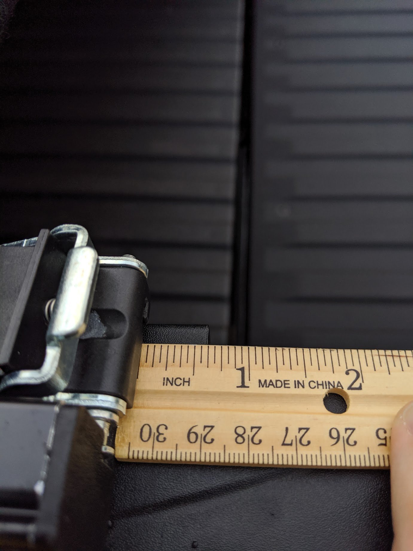

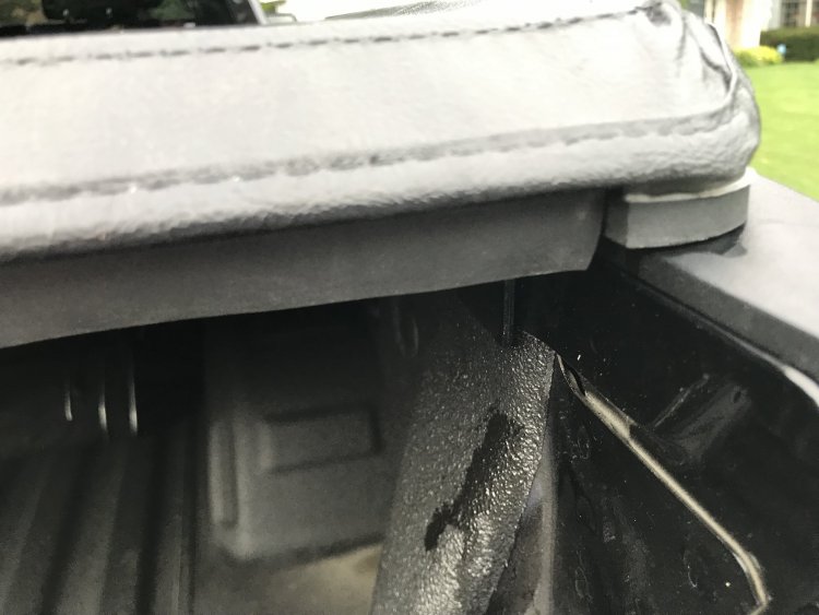

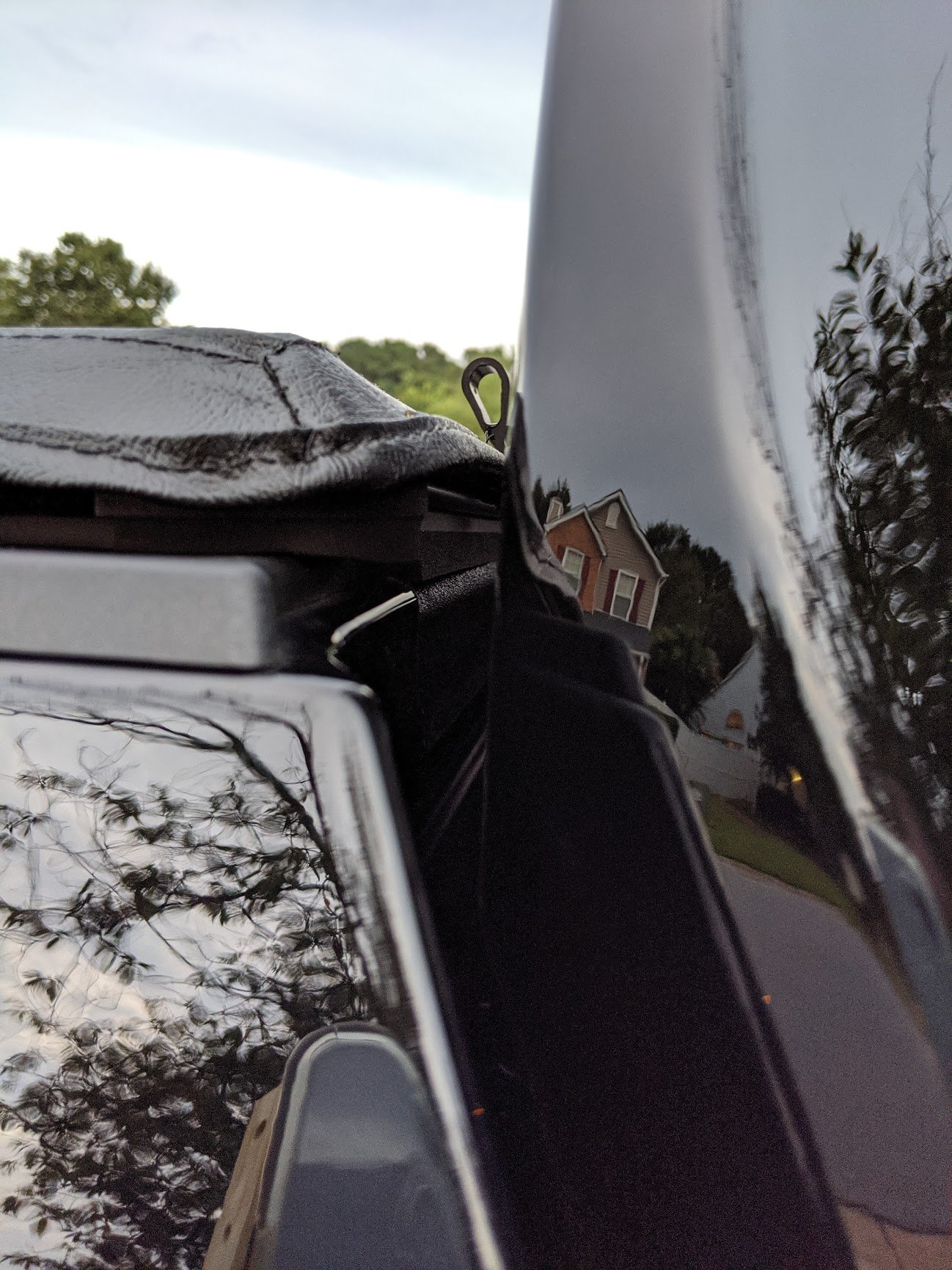

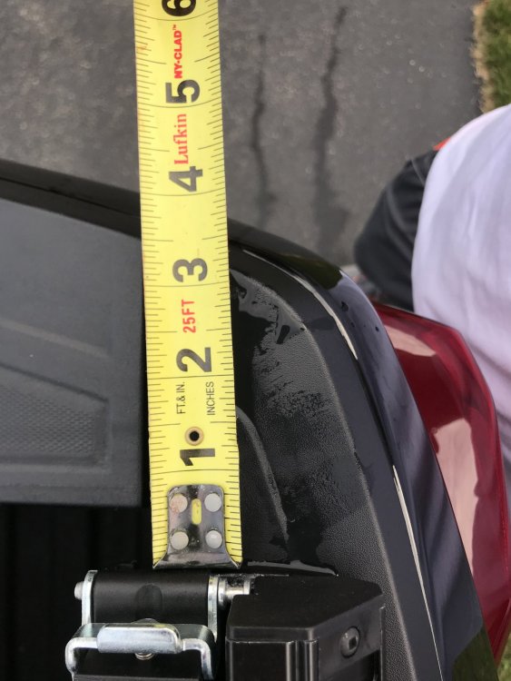

Move the rails closer to the cab of the truck. Here's some pictures with measurements to help you out. My tailgate opens just fine and water doesn't really get in with them placed here. Hope this helps!
yeah I'm pretty close to the window as is. Looks like yours is touching and I'm not sure I want to go that route. I'll measure though and see what I can do.
I was also thinking of greasing/taping the weather stripping up as i don't see a real need for it. the seal in my 16 was just fine without it.

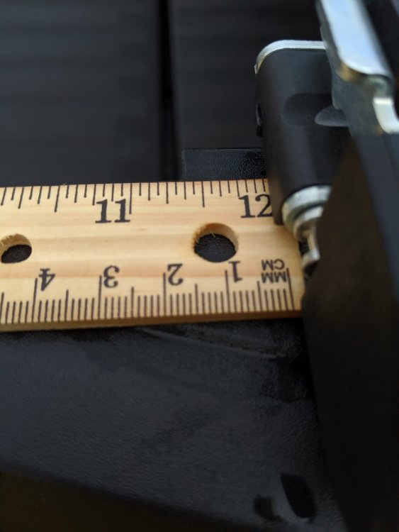

looks like i'm even farther back than you. I think I have it narrowed down to the weather stripping being to wide and have asked if they can send me a thinner strip as I was able to "fix" the issue by using electrical tape to life the stripping up.
That's crazy. I wonder why yours is farther back and it still catches. Maybe the covers aren't the same length? Also, the cover isn't actually touching the window. I was trying to show where the weather stripping on the bottom of the back rail was in relation to the back of the bed. It honestly took me 4 times of taking it off and shifting it back before it wouldn't catch. That absolutely drove me crazy because the tailgate release is cool but it's also really handy.
