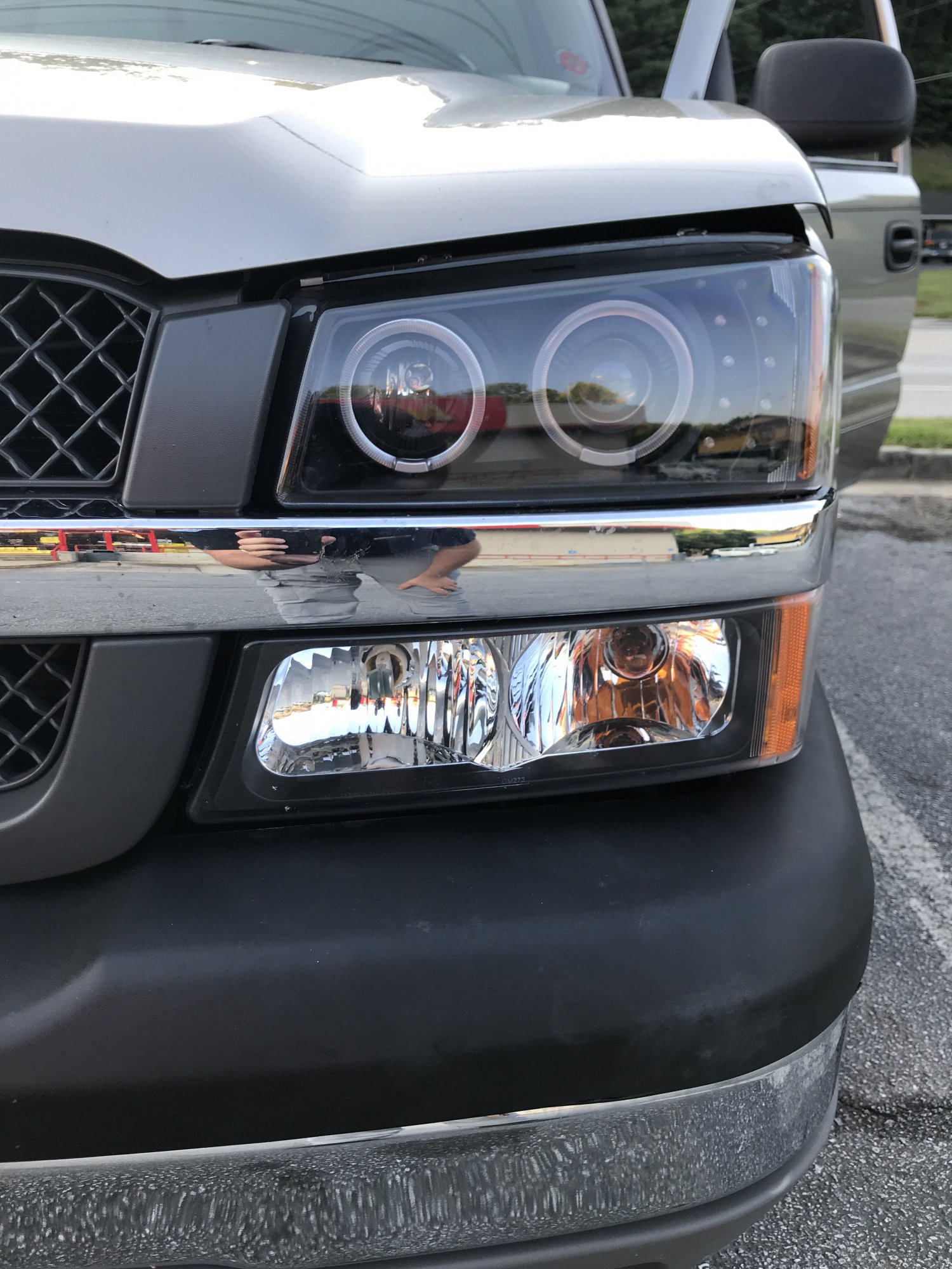

Okay I have a question. I recently had my headlights replaced from the stock light to the Spyder Black Halo Projector Headlights with LED DRL. The body shop put my HID ballast and bulbs in but they would not work. So I took out the HID ballast and put the original headlights back in and connectors and I pulled a amateur move when doing so, I did not wrap the positive wire up prior to putting the headlights in. So when I went out to adjust them it grounded out and now the low beams wont come on at all. I have swapped the fuses from the hi beams to the low beams and the high beams work with the fuse from the low beams and the low beams still don't. Also when I turn the headlights on I can hear the click in the fuse box. I was wondering what else it could be? I was thinking it could be the pigtail connector??
Any other suggestions would be greatly appreciated.

I will try that here in a few.  This is what the factory headlight connector which is the female end from the truck to the lights. Both the hid ballast and led connector share the same connection.
That's definitely the wrong connector for a halogen headlamp - there should be 3 pins, not two. Need pins for high, low, and ground.
That pic looks like the plug for fog lamps.

My Silverado has cat eye headlights so the low beam and high beam are completely separate bulbs. It was a simple fix. It was a damn 10A fuse I forgot was there and to check. Everything works fine now. Thank you for all your help.
