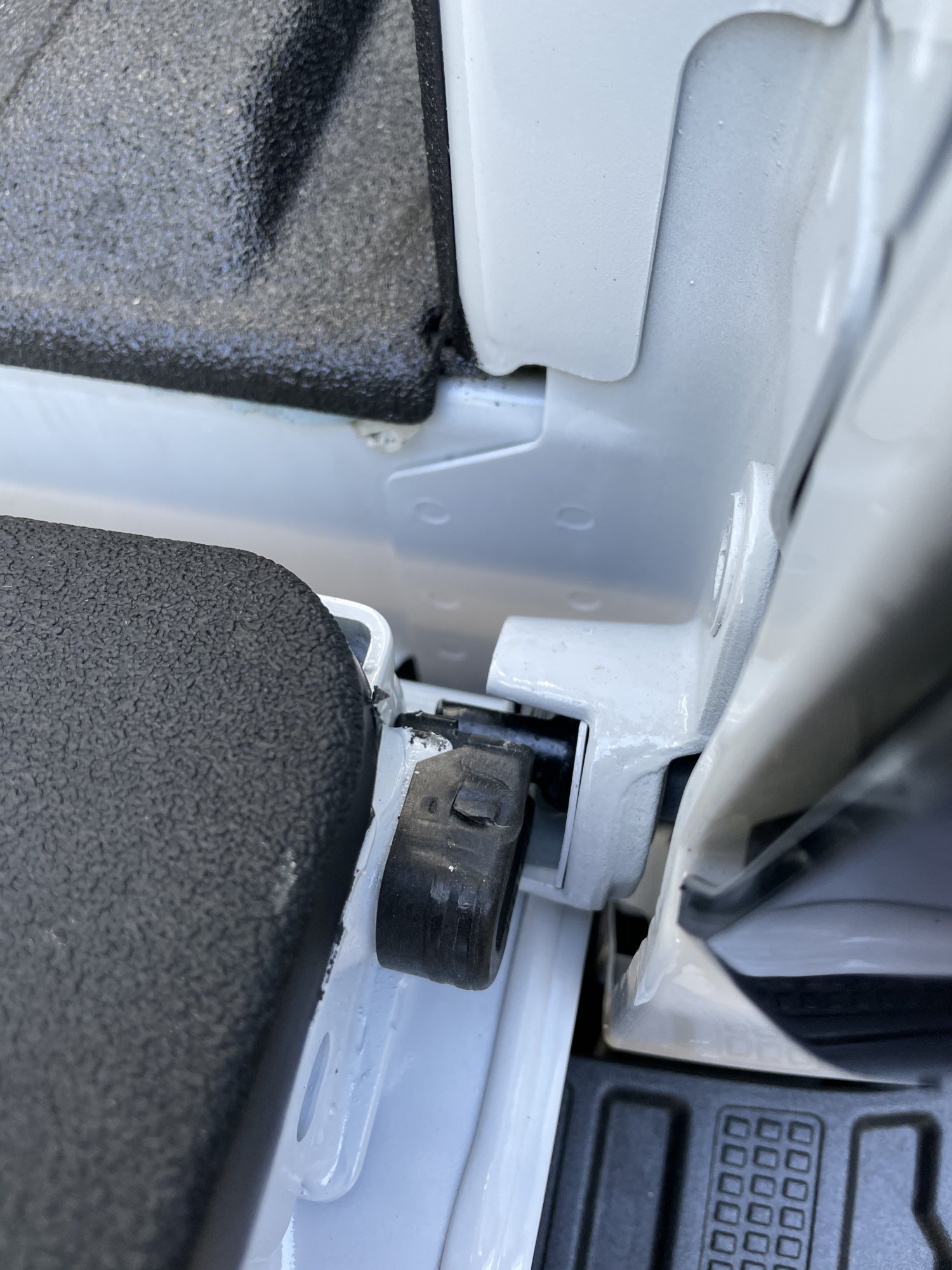

Any suggestions for getting the passenger side back on on a 2020 GMC 2500 At4 with the multipro (if that matters)?
I was lifting the tailgate up and pulled it off the passenger side. Can't seem to get the angle anywhere that looks like it might work.
Thanks!
Thanks!
Nevermind. Rotated piece on truck.

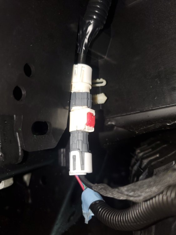

I have a 2nd connector from tailgate harness, anyone know how to disconnect this one 😛
Slide the red tab down and then press on  the white tab beneath it and pull apart.
