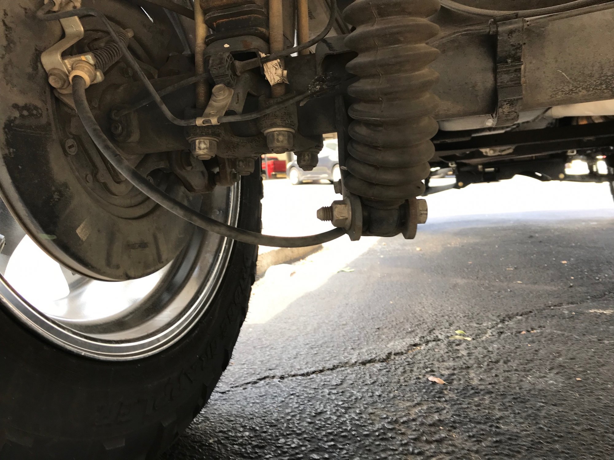

I am wanting to add the Rough Country traction bars to my truck since I get a lot of hop in the rear end with the 6.2 acceleration. I noticed they attach to the U-bolts on the rear, but mine are all the way maxed out since I added an extra block for leveling the truck(pic attached). I'm curious where I can get new lo nger U-bolts and from where ? My guess another 1/2" to 3/4" would do it.

.. any local spring/chassis shop can make you a set any size you wish
I guess I was just wanting to order a longer set since I will be doing the traction bar install my self. I was curious what the size of these would be on a Fabtech 6" lift.
Use your tape measure, add an inch and order a set online. Easy, Peasy.
Once you’ve got the traction bars installed, you’ll wonder why they aren’t OEM on every one of these trucks.
