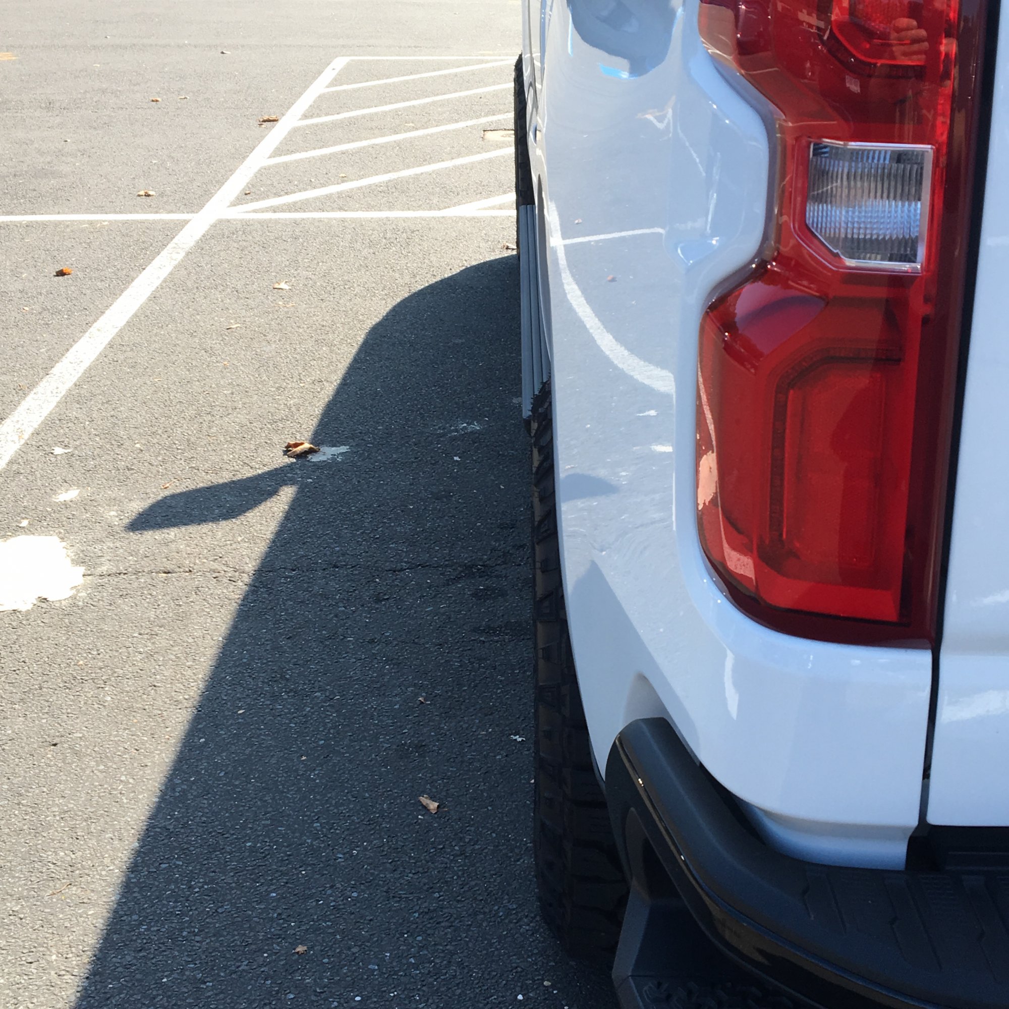

Spacing to run 305/55/r20 on stock rims.  Ive seen TB owners do it with +20 offset 9" rims and no rub.  However these are +27 I think.

I’m gonna throw some bora 1.25 on this weekend ( trail boss )  I’ll let you all know if studs need to be cut . I don’t think they would with the wheel pockets hopefully my measurements backs that up lol .
I’m gonna throw some bora 1.25 on this weekend ( trail boss )  I’ll let you all know if studs need to be cut . I don’t think they would with the wheel pockets hopefully my measurements backs that up lol .  Yes on stock trailboss 18 inch wheels tires are also stock 275
