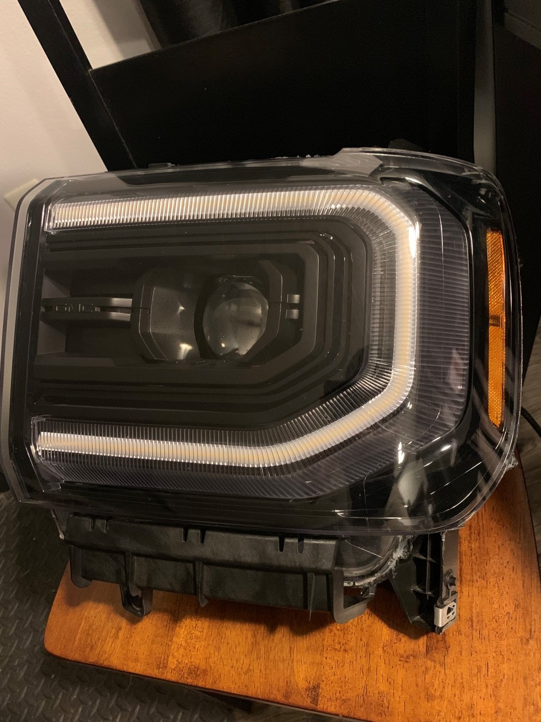

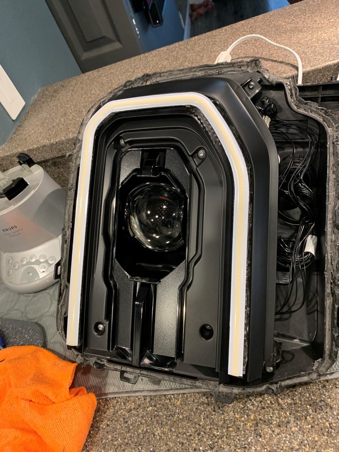

R1talin Posted October 14, 2019 Share Posted October 14, 2019 I pulled mine apart, painted the internals black and installed the diode dynamics LED's. no halos though. Quote Link to comment Share on other sites More sharing options...

hackitz Posted October 14, 2019 Author Share Posted October 14, 2019 nice work, did you have to put them in the oven to heat up the adhesive? what glue/adhesive did you use to reseal them? also what are: diode dynamics LED's, can they change color? Quote Link to comment Share on other sites More sharing options...

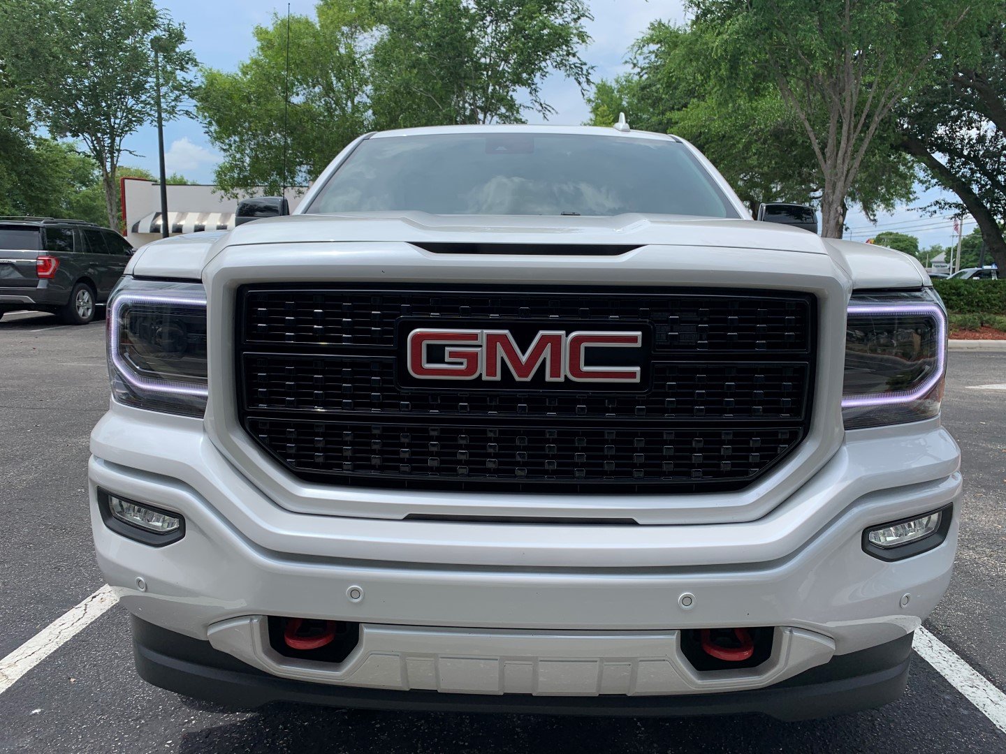

Frankielozano214 Posted October 14, 2019 Share Posted October 14, 2019 1 hour ago, R1talin said: ....very carefully : ) Have to admit those headlights look good Quote Link to comment Share on other sites More sharing options...
R1talin Posted October 14, 2019 Share Posted October 14, 2019 55 minutes ago, hackitz said: nice work, did you have to put them in the oven to heat up the adhesive? what glue/adhesive did you use to reseal them? also what are: diode dynamics LED's, can they change color? Thanks. I did put them in the oven but these headlights use permaseal instead of the old school rubber butyl glue so heat is not as effective and it took a long time to get them apart as i took my time, not wanting to break anything. If you use the oven make sure you put a wet cloth on top and bottom of the headlight otherwise besides melting, the clear cover will spiderweb if you leave it in too long. It took me about 2.5 hours to open each light, slowing prying the permaseal apart inch by inch ad reheating. Cleaned the tracks out with a dremel before resealing and cleaned off the clear lens edges. I resealed them with standard automotive rubber butyl glue and the oven, then taped them up and let them dry/harden overnight. I did mine about 10 months ago and have had no issues with moisture. As long as you take your time and clean the tracks before reassembly you won't either. Diode dynamics boards are bright white and turn amber for the turn signals/flasher. They have no other color changing ability. https://www.diodedynamics.com/2016-2018-gmc-sierra-led-halos.html 1 Quote Link to comment Share on other sites More sharing options...
