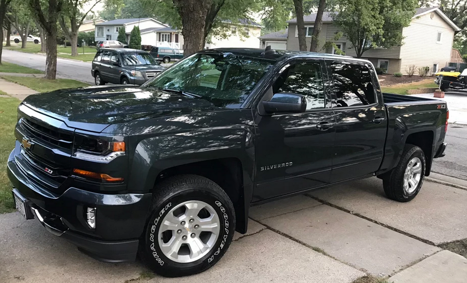

Looking for new tires and wheels, any suggestions?
I've had my 2018 now for a bit over a year with about 13,000 miles and I am thinking of finally changing out my tires and wheels. Good thing is that with such low mileage, I was looking around and my tries can still fetch a few bucks and of course I'd be selling the current wheels. I currently have the Goodyear Wrangler Fortitude HT's, and these past few months I haven't felt like they have been that good in the rain and with winter on the way, plus I want to have a bit more aggressive looking tires/wheels.
My current tires are a 265/65R18, would I be able to get a set of 20's on here without any kind of rubbing occurring? I'll probably get a 2 inch lift/level done on this truck at some point next year, just want to make sure if I went with 20's that I won't have any issues. Plus I plan to also get Katzkins installed later this Fall.
The truck is a graphite color (added a pic of the truck), and I was considering getting the Nitto Ridge Grapplers and the Moto Metal Black MO970 wheels.
https://realtruck.com/p/moto-metal-matte-black-mo970-wheels/v/chevy/silverado-1500/2018/
Any other thoughts or suggestions?

Thanks for the recommendation on the 20" wheels. What size can I get on here without any rubbing occurring since I don't have any kind of lift at the moment and would I need to have my speedo re-calibrated if I went with a slightly larger tire?
I'll be looking for a smooth ride for sure, my wife drives the truck too and she will complain if this thing is all bumpy as hell on the road. LOL!
Are the Nitto Grapplers good or should I be looking at the G2's?
I do like the look of the Nemesis wheels, never considered those and will add them to the list now. I just found these on Real Truck and like this set of wheels too:
https://realtruck.com/p/ultra-matte-black-nemesis-wheels/v/chevy/silverado-1500/2018/#
You are going to want to stay under the 33in tires and if you have mud flaps you must take that into account too. If you go with a larger tire you will get closer to the mudflap and it may rub on tight turns. Also remember the wheel offset, if it is a lot different than stock and pokes out more it will change where the tire could rub as well.
The weight difference between a 265/65/18 Ridge grappler to terra grappler is only 3 pounds, so that would be a non issue in stock size. The Ridge Grappler has much larger lugs/blocks to the tread pattern so that may make them louder and slightly more rough riding than say the Terra Grapple tread design.
A 275/65/18 tire is about .5 inches wider and .5 inches taller than the stock size. That would be a safe option because you know you wouldn't have any rubbing concerns.
