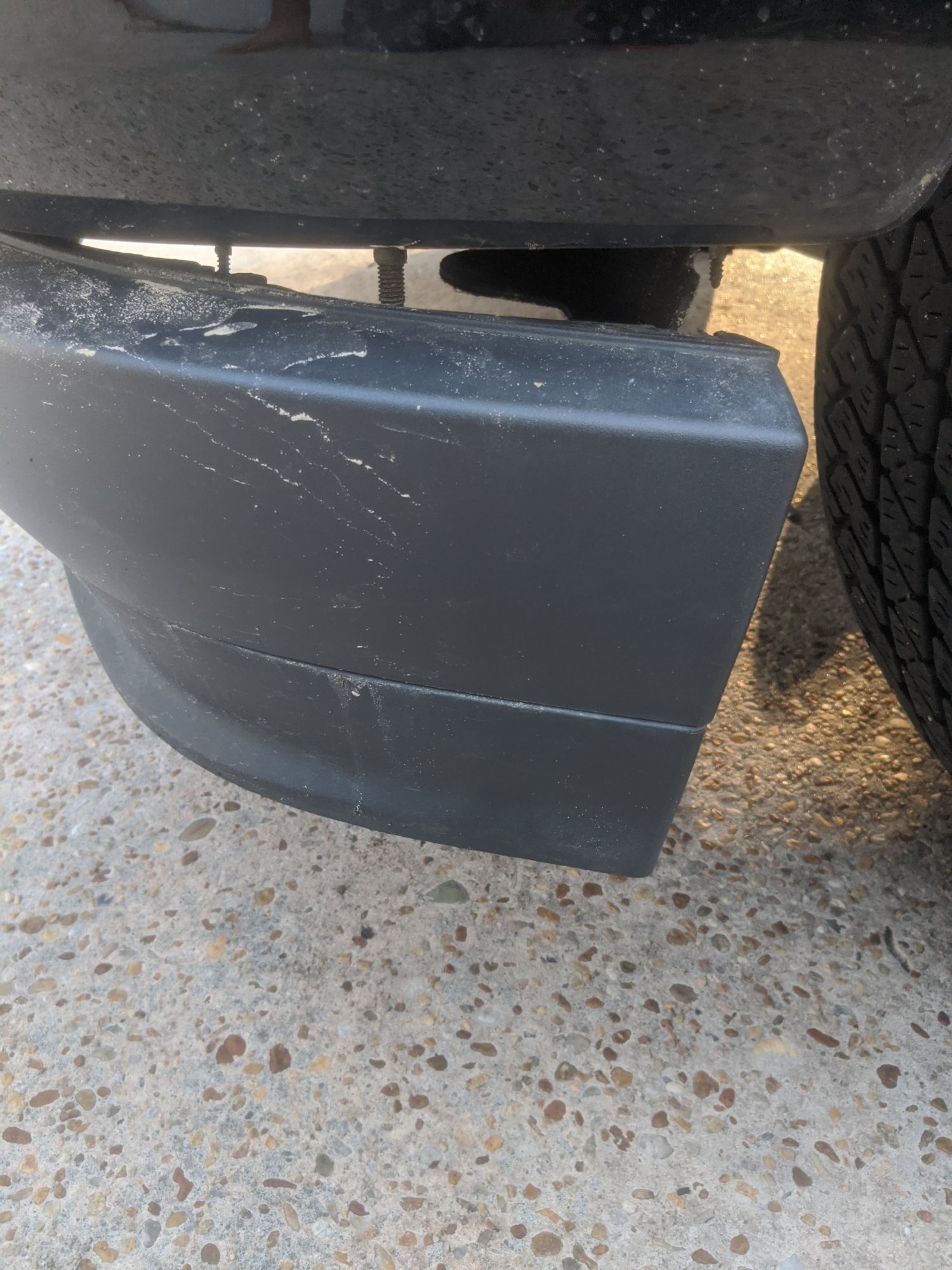

Hey everyone.
I've got a 2017 Silverado LTZ.  I some how how managed to damage my air dam/deflector under my bumper.  Instead of purchasing a new one does anyone have an easy fix to get it back on?  I've got a couple pics attached.  The actual clip broke off and a part of the plastic where the clip was attached.  It's part 23496677

Take it off, will look better without it!
I thought about doing that too.  Does it have a big effect on MPG?
Maybe .5 mpg. Not a huge difference
I took the lower part off of mine and like the look, as it doesn't look so low to the ground. I think it was about 15 screws.  So far as the damage - my son did something similar to his 07.  We just added a fender washer under the plastic and reattached it.  If necessary, you may need to use a small bolt through the washer.
You probably hit a snow bank or something while parking it and it got pushed back and snapped.
Remove it or few screws from the bottom may fix it. New ones are under $100 online.
Remove it or replace it, imo.  This is a body part and shouldn't be tied on with straps or miscellaneous nuts and bolts. (unless temporary)   As a general rule, it doesn't matter if my repairs are not seen by others. I know the quality of repair and that is what matters.  You also don't want future potential purchasers finding a mickey mouse repair. It will speak to how well you have cared for your truck.
