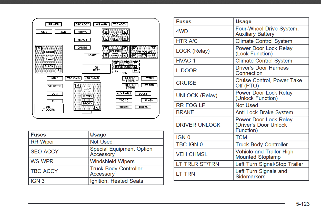

That sounds like a great way to fix it to me. This is probably a dumb question, I have very limited experience working on modern cars. Can someone tell me how I can trace down the correct fuse to pull?
Owner's manual will have a diagram of all fuse locations
Fuse location is in the instrument panel fuse block on the drivers side of the IP (when you open the driver's door, it's staring you in the face).  Shows to be fuse IGN3.  I don't know if pulling the fuse will affect the ignition or not...pull fuse and see what happens.  If it does affect the ignition, replace the fuse and just unplug the connector to the seat heater (should be under the seat)1053746943_Screenshot_2020-01-19GMOwnerManuals-2004-Chevrolet-Silveradopdf.thumb.png.c145e6352b0973271e86511b38c6fe4c.png
Ok great info! Thanks man. Wish now the truck had Manual seat adjustments instead of power. Unplugging the seat would be the best option except it probably won’t let me change the seat position (I have to deal with kids car seats sometimes).  I’ll play around with it and see what happens.
