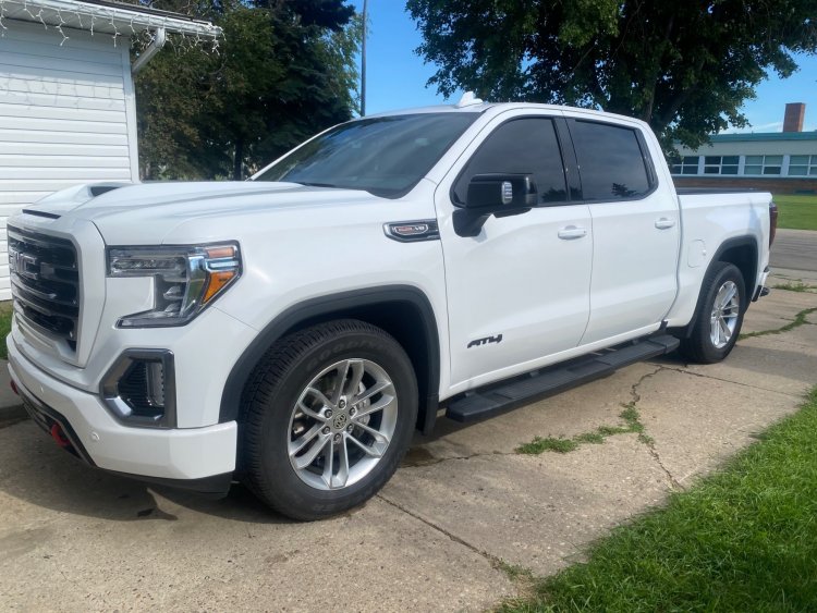

upgrading to an at4 or denali, and just signed up cause of this - gregorio sounds like he knows what he's talking about on dechrome part swap - but anyone else have any numbers they want to share?  (for denali)   $6500 sounds like a lot
I checked prices on elevation trim parts and am getting lower.. but maybe you cant swap some

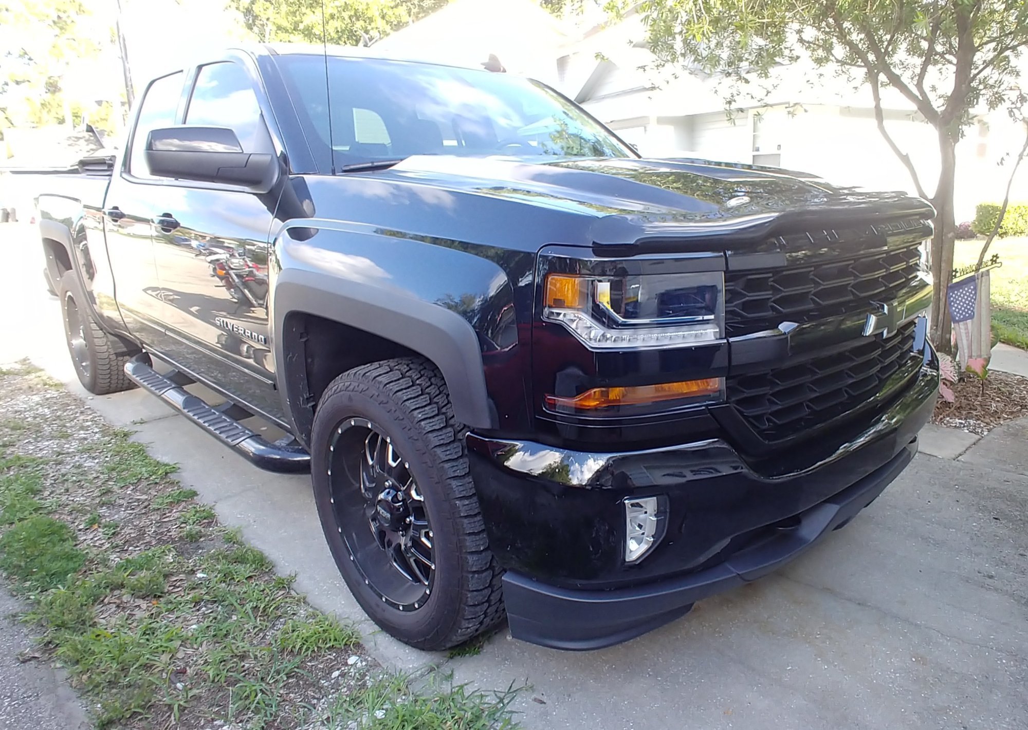

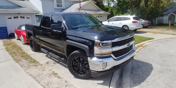

On my old 2017 I did an LT chrome conversion to body colored bumpers and grille and headlight bezels. I decided to remove the bumpers and get them powdercoated ($300 for both). Ordered the body colored grille though dealer for about $500. Ordered new paintable headlight bezels ($200). Got them Painted ($100). So I did the complete switch for just over a grand in parts and paint.

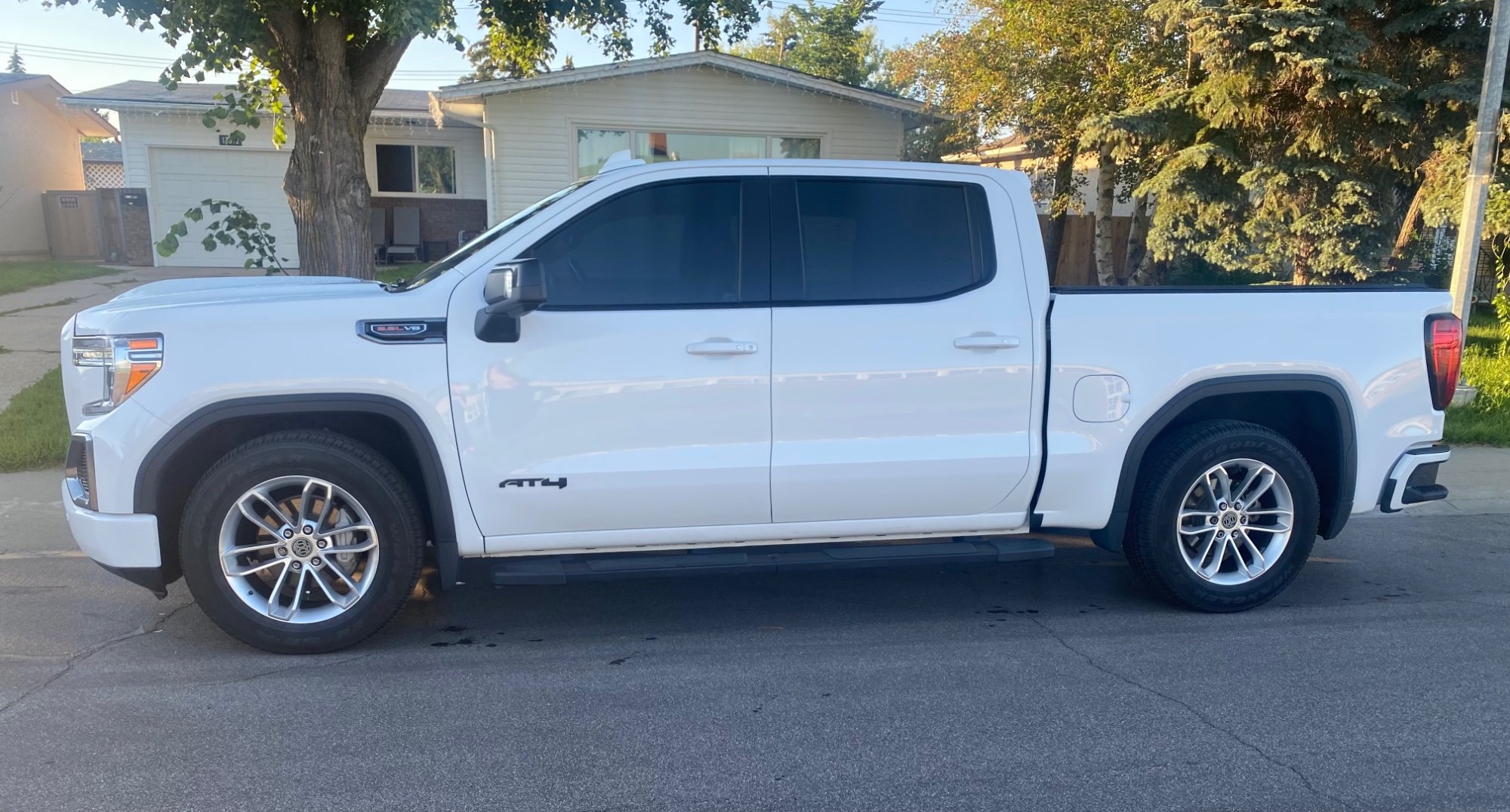

I posted awhile back that I was following. Never saw anyone lower their at4 so i went ahead and did it. 4” drop all around. Bilstein 5100’s meant for the slt/elevation, oem axles for the slt/elevation, beltech 2” drop shackles for the rear, beltech 2” drop spindles for the front and custom made ubolts for the rear from a shop.
