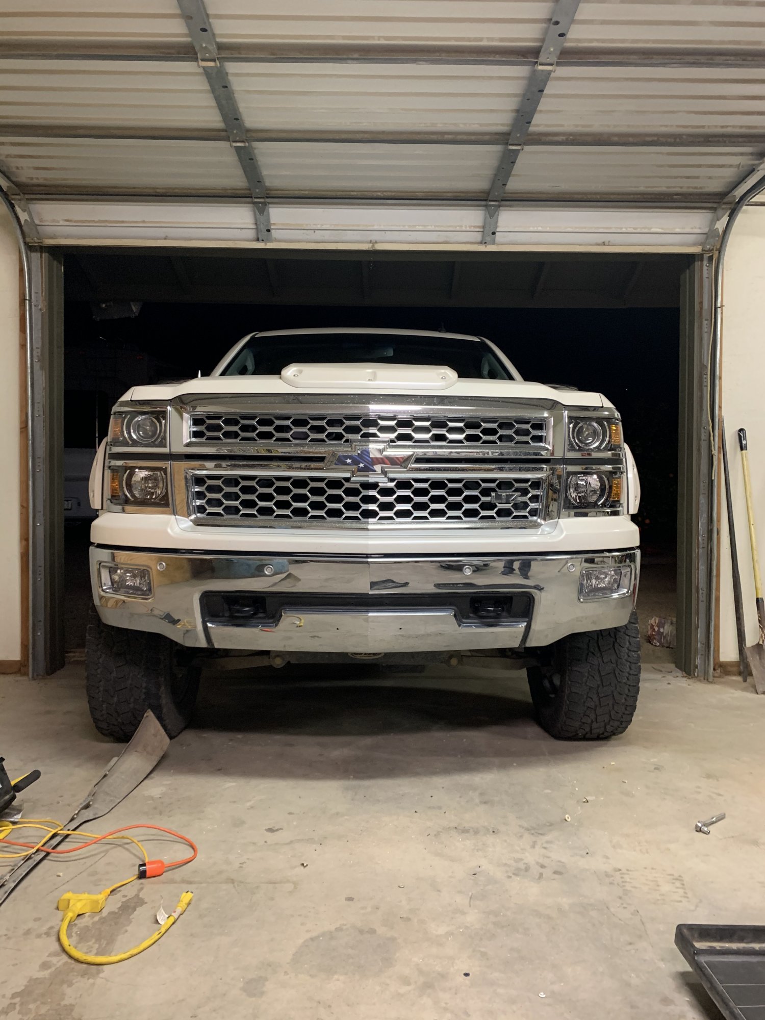

I have a six inch pro comp lift kit and I’m wondering if anyone on here has tried running a lift and a level to get extra clearance for bigger tires.

I wouldn't do that.
Your angles will be horrendous.
To do what you want (run 37's) you need 9" of lift.
Take the 6" kit off your truck and replace it with this...
