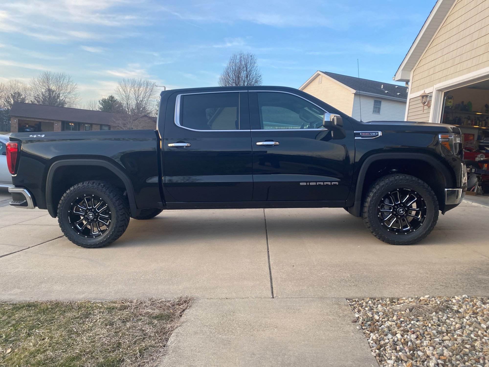

You'll be able to run 33s on aftermarket wheels, maybe close to a 34 if you have a close to stock offset. I have stock wheels on my AT4 and run 35s with very minimal rubbing turning on inclines.

 it'll probably rub  and need trimming done to mud flap  and crash bars removed from behind liner. This is my slt with a 3 in. lift  which is technically an inch higher than the stock at4  in front . im running a 305 55 r20   cooper st maxx which is 33.4 x 12.5  on a +5 rim it rubbed like crazy until i trimmed alot  if you run a 33 12.50. i would find one that runs true 33 only or a little smaller  it might be less trimming .
