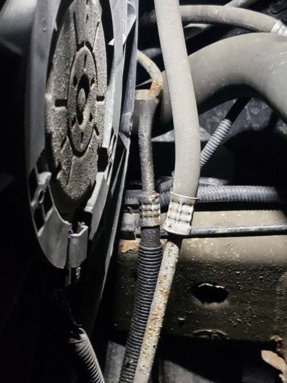

Also what are these 2 lines in the pic? It looks like they go to the radiator, but it could be to the tranny cooler. It looks like one of them has a slow leak by the damp crud collected on the line and the wet spot on the skid plate. Any experience with that condition? I haven't noticed any low levels on coolant or tranny fluid. It does burn a good amount of oil, I guess due to the afm. I'd like to shut that off permanently.

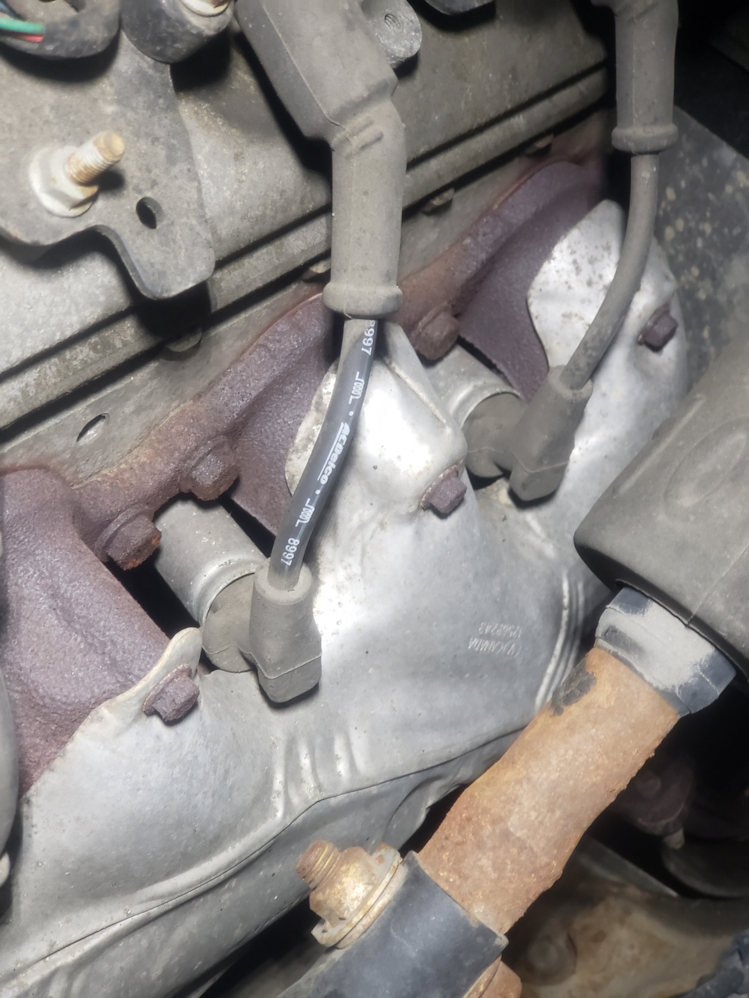

Here's a shot in the dark: Is this the original plug wire? I've watched some plugs and wires change vids on the webs and other original wires are red. I'm assuming these are the original plugs and wires because the wire part #(8997) doesn't turn anything up on the web (due to age?), and if you were going to trade this truck in at 100k why would you spend money on the scheduled maintenance. Wire color must vary between years, motors, GM/Chevy). I suppose the definitive way to tell would be to pull a plug and see if it has the original part number.

The smaller lines in the center of the first pic are probably the transmission cooler lines.  They typically don't fail, just weep/leak oil over time from where all the crimped connections are between rubber hose and metal line.  Same with the oil cooler lines and the power steering lines.

I replaced the transmission, oil, and power steering lines over time because they were weeping/leaking.
