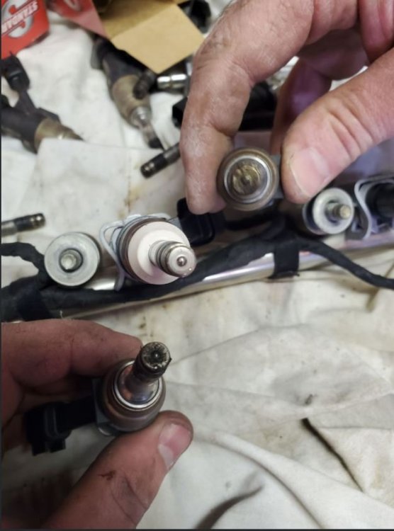

It started with P219a once ever few weeks or so when it was cold out. P219a started coming on more frequently, even when it was above freezing. Then I started getting P050D "Cold Start Rough Idle", and I even had a few codes for misfires. I replaced the spark plugs and wires a few months ago and it didn't change anything. I decided to try changing the fuel injectors once it got to the point where I couldn't go more than a couple days without the check engine light coming on.
I was shocked to see how dirty the old injectors were compared to a brand new one. It took about 5 hours to change the injectors with a little bit of help. So far, so good! I have also seen an increase in fuel economy.
