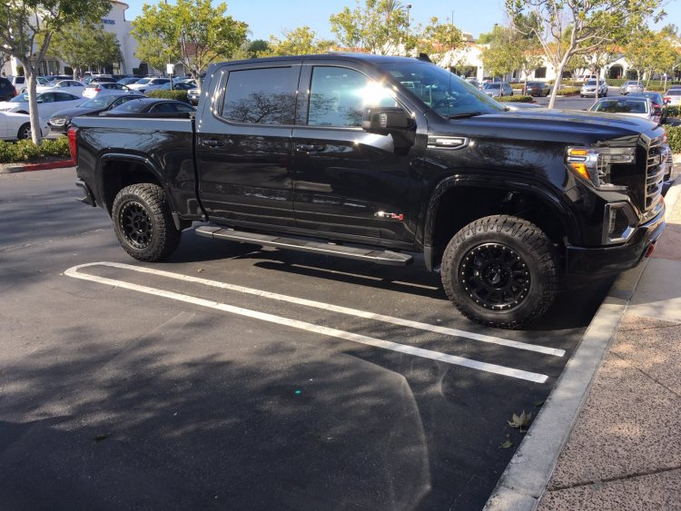

Here is my truck - leveled with Ready LIft SST kit, when it first when on (bottom pic and the after I added wheels - stayed with stock tires for now.  SST kit comes with 0.5" taller block for rear to made it fully level.
Methods.thumb.JPG.9d0460c90210bba9f56bc59e1eadaeb5.JPG1774283387_LeveledTruck.thumb.jpg.b8535f0f8e583d235494bdb8729f1b63.jpg

Thanks for the pics. I have a 2021 1500 AT4 and just had the SST 2 inch kit installed. I love the look of the kit and rides ok. I say ok because the ride isn't as smooth as before. More bumpier than before the kit. Everything else is OEM and I'm wondering if it is worth the 2 inches now. I plan to put Nitto 33's with 22x10 (-18) 4 Play wheels on it and need it to fit the 33's. Just seeing who else have had the same issue.
@SupercupThanks for the pics. I have a 2021 1500 AT4 and just had the SST 2 inch kit installed. I love the look of the kit and rides ok. I say ok because the ride isn't as smooth as before. More bumpier than before the kit. Everything else is OEM and I'm wondering if it is worth the 2 inches now. I plan to put Nitto 33's with 22x10 (-18) 4 Play wheels on it and need it to fit the 33's. Just seeing who else have had the same issue.
