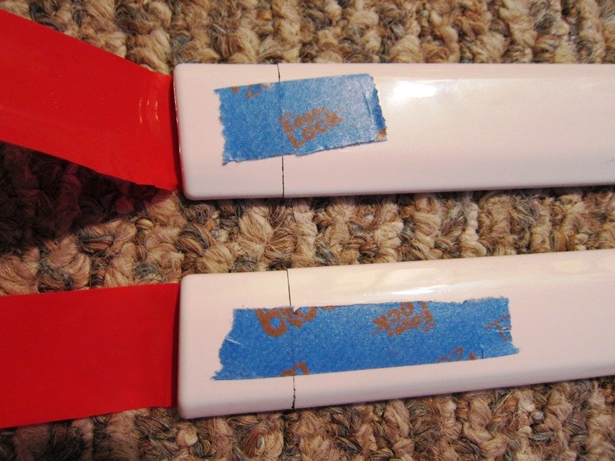

Turns out, you can't simply "trim" off the end of the body side molding. It's formed on the end to be a color finish. That sucks. So now I have to section out what I don't want and fuse the end back on. This was going to be fun.
Here's what the end piece looks like if you cut it.
So now I have to section out what I don't want, and by my measurements, the front will only be about 19" long.  The Denali emblem takes up some space.

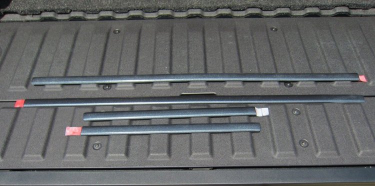

Here's what I had to work with, so using a blade for cutting plastic on my chop saw, I trimmed out the section I didn't need, and used JB Weld Plastic epoxy to glue the end back to the shortened piece. Whoever made these for GM has some fairly uneven molds as I found out. Thickness and width aren't 100% accruate when you take a chunk out of the middle of one. Down below is a picture of the shortened fronts and the piece at the bottom is the section that was removed.
There's a close up of the glued ends in the bottom pic. They'll need a bit of work with the sanding, but they should do just fine.

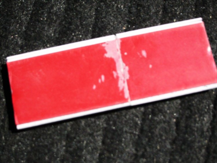

It's a work in progress, so to see if it was even going to work, I cut two pieces off the sectioned part, and glued them together, sanded them, and used it as a test piece to see if I could make them look sort of factory.
Looks very passable. On the back side, you can see the seam on the back where it was glued together.

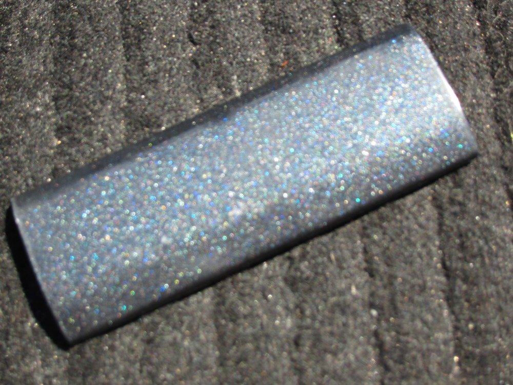

Sanding and sanding and then painting.
Here they are after the clear has dried. Now I have to color sand and buff them smooth.
The color seems to be spot on, and no discernable seams.
Also seems I was able to match the color. Not done yet, but I'll come back tomorrow and hopefully I can get them installed after color sand/buffing and then post up. Probably the only Dark Sky set on earth!

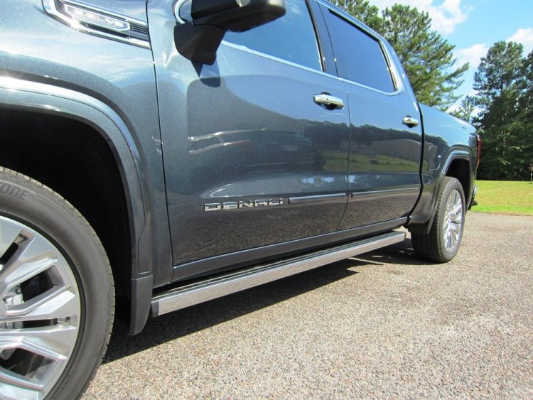

Got around to sticking them on today. Wife wasn't impressed. She said they're not really that noticeable and kind of get lost in the background. To which I replied, this is exactly what I was hoping for. Just kind of hanging out virtually unnoticed. That's why I didn't want the chrome. Everyone's cup of tea? No. But I like them. Makes me sleep easier. Not a panacea against dings, but I can breathe a little easier without it looking too gaudy. One thing I can say about GM molding adhesive. That crap is like super glue. Once it sticks, it's stuck.
