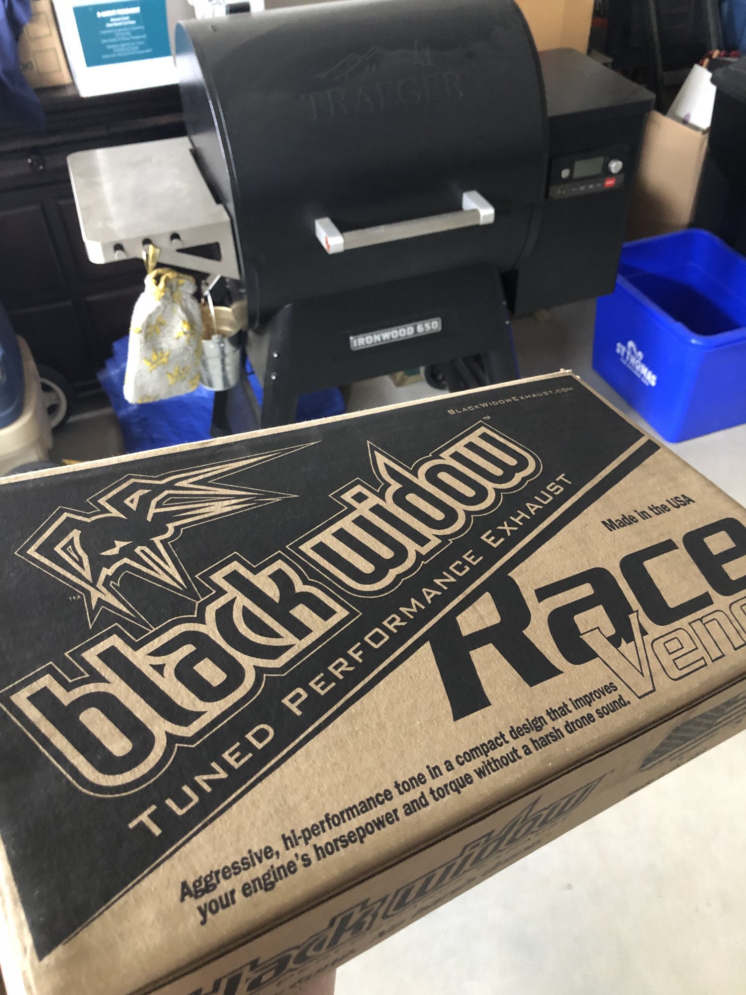

I had a race venom in my 18, I bought another for my 2020 . Getting installed monday , deleting the flapper and resonators .
on my 18 it sounded fierce. Every time I went somewhere people asked me what I had in her.
I will let you know Monday how she sounds through the duals
Also just a note the angry Housewife is just a shorter race venom , apparently its not quite as loud as the regular race venom , but a little less raspy. (I like the rasp in the race venom) Stock right now is pretty crappy but looking underneath the truck I recommend an offset-offset or an offset center. 3”.
delete flapper 100%.
Just a note , I installed the muffler today , deleted the flapper.
I opted to try it with the resonator screens left on, factory dual setup for research purposes lol.
The resonators really really really quiet the good tone. I will post a couple videos.

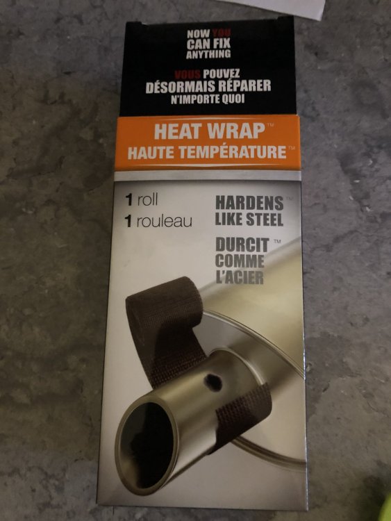

There is no drone at all with resonators in place. I went ahead and covered the first two on each side . So 4 of 6 . Leaving only the rear 2 (1 on each side) open.
With this setup you can just barely hear it in the cab if you let off the gas and re engage the pedal at a cruising speed of 60km. I wouldnt call it drone though, the tire noise of the duratracs is louder.
I will get some clips , im going to cut the pipe section out with all 3 resonators and replace it with a piece of 3” stainless. So far its not as loud as my 18.
Btw I used this to cover the resonators.
