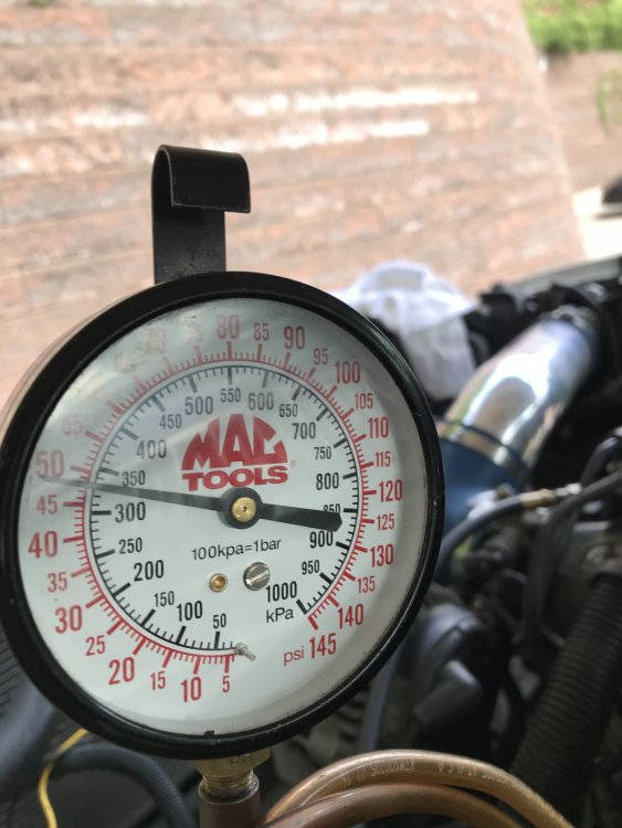

Just did Fuel compression test : with truck key turned over but not started about 53 psi , with the truck started it dropped down to about 48psi . With engine in park and rev’d to 2500 it went down to about 43 or 45 psi
That's pretty low for fuel pressure. It should stay above 50psi and increase in pressure to around 58psi under heavy load.
Under heavy load ( in park with it rev’d to 3k rpm it’s at 43psi . So I’m guessing with a new pump it should stop the random missfires above 2k rpm .. probably why it’s missing cause it isn’t getting enough gas
Yeah it's a possible weak fuel pump or bad fuel pressure regulator on the fuel rail.
