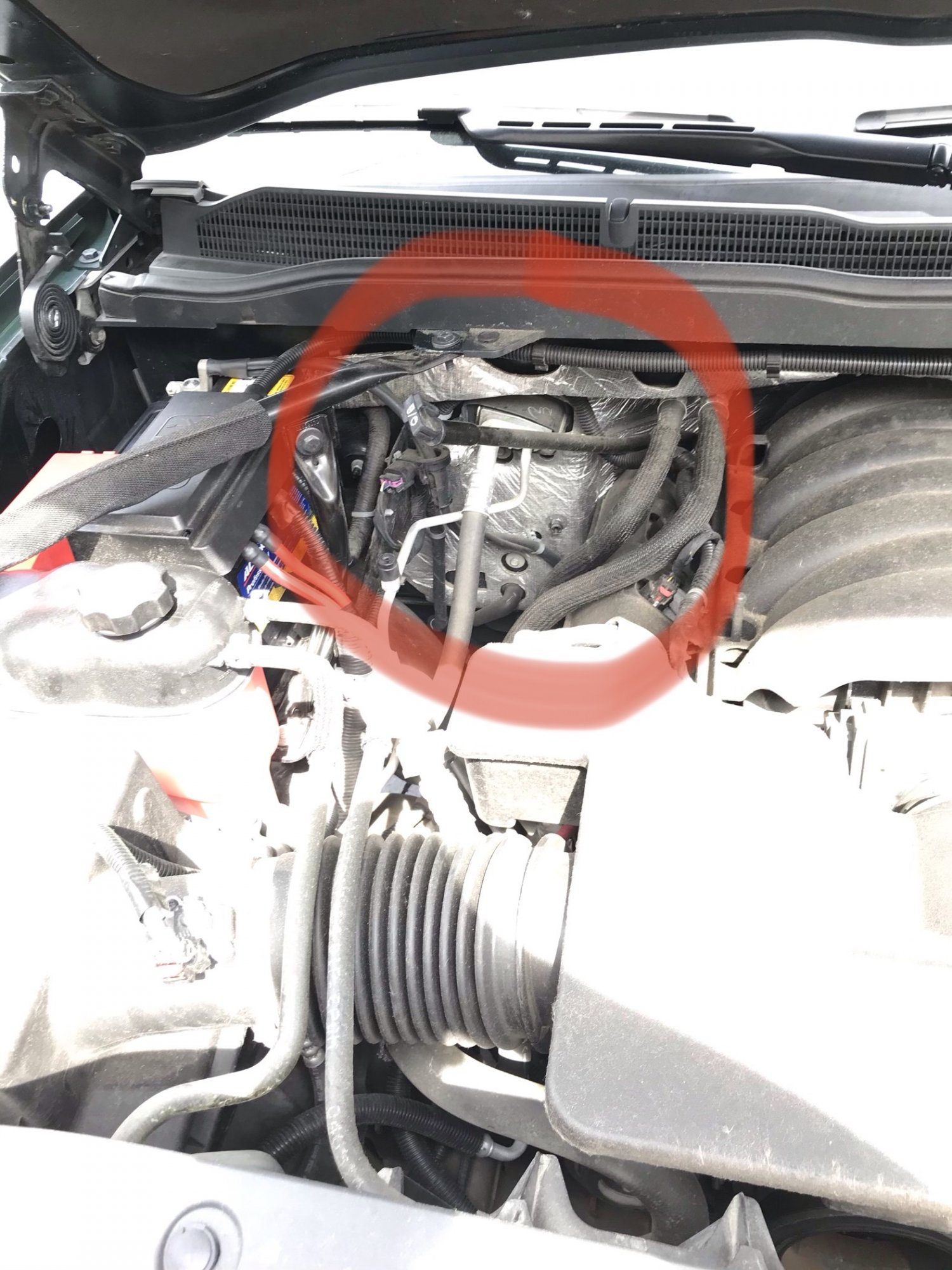

Hey Guys,
I can't seem to figure out what this is on my truck. There seems to be water draining out of here after every drive (not a lot, but enough to make a small puddle). I am fairly certain its water after the feel/smell test, but I just had my coolant flushed before I started noticing this so wasn't sure if it was a coincidence or a related issue. I'm fairly mechanically inclined, but admit I have no idea what this part of the truck is.

That's the drain from the evaporator.  Those two lines above it are what go into your evaporator in the dash board.  All vehicles have this.

Turn on your truck, fire up the AC to max, and then watch the water start to flow.
It does not do it 100 percent of the time, but vey close, especially during the summer months.
