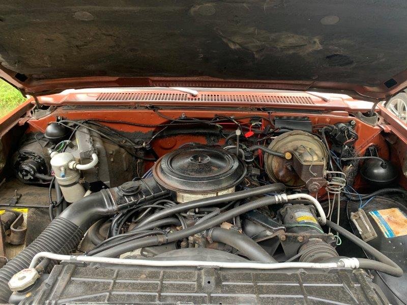

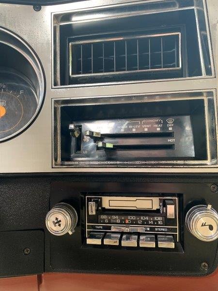

Who would fill the AC for me on such an old rig

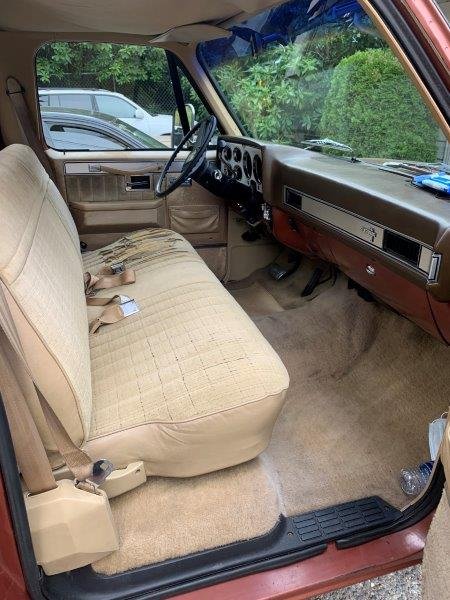

If I should reupholster the seat
If I should have the headliner re done
If I should buy a carburetor or leave the original

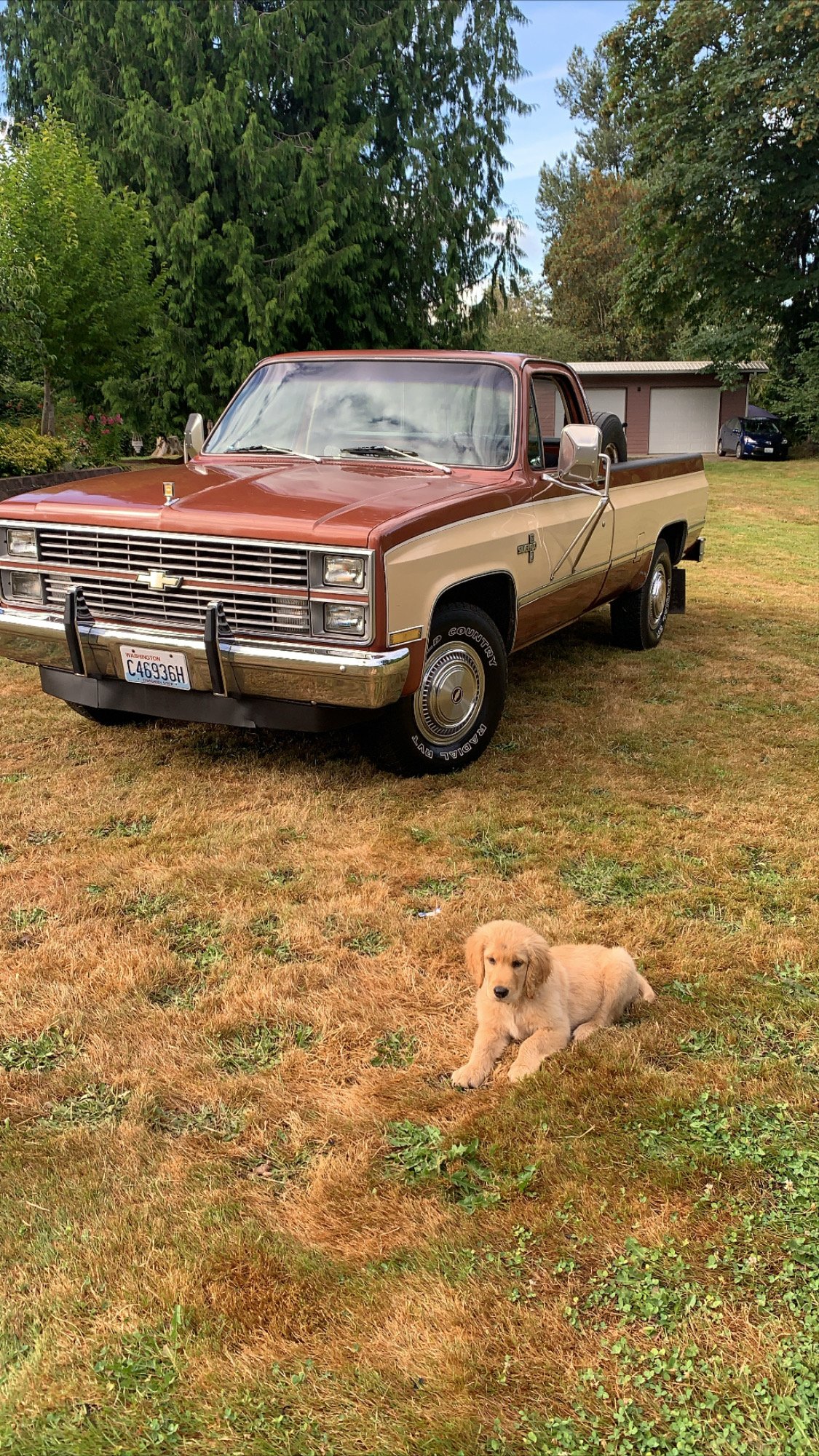

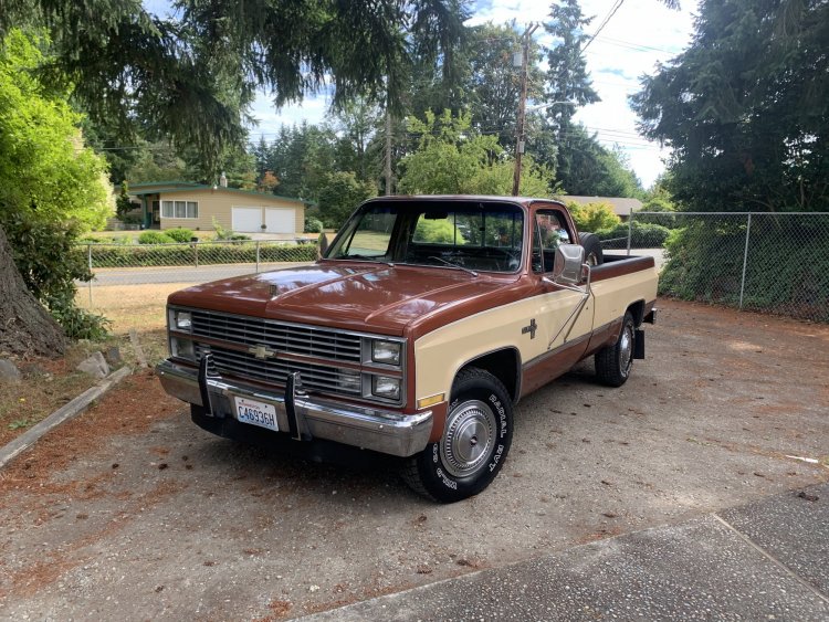

So here it is, my 1983 3-on-the-tree 7.4l 454 big block v8 metallic bronze and almond silverado with the trailer tow package and premium chrome wheels

Welcome, very nice looking truck, exterior paint looks great, maybe just a little dent on top of the tailgate?  Interior pictures would be helpful if you want opinions on replacing the seat upholstery and headliner. I used to have an 84
K20 HD camper special so I'm very familiar with this era of square bodies. You mentioned that the transmission was a three on a tree but that refers to a manual transmission, I would speculate that you have the TH400 automatic with that 454, if a manual was available with the 454 it would have been a HD 4 speed with compound or granny low. My 84 was just a 350 with the HD 4 speed manual and 3.73 gears. Also those aren't premium chrome wheels, they are just the premium hubcaps with a painted steel wheel underneath. I had the same ones on my 84 with the exception that the front hubcaps had the cutout for the 4wd hubs, steel wheels were painted white. I notice that your spare tire has been relocated to the bed, did a previous owner add an auxiliary gas tank in it's place? If so, that's a bonus! I assume you already have the dual saddle tanks, but no pictures of the passenger side so I can't confirm that. Again nice looking truck!  Oh, one other thing, your truck appears to be a C20, not a K20 4wd which you have listed along with your Avatar.

Thanks for the reply and it’s good to be here. I was rushing when I made the post, it is a c20. And you are right about the TH400. I’m learning this all as fast as I can. I have a left and right gas tank, yes. The build sheet shows the side mount spare wheel as an option(P13) but I believe the original side mount hardware was replaced.

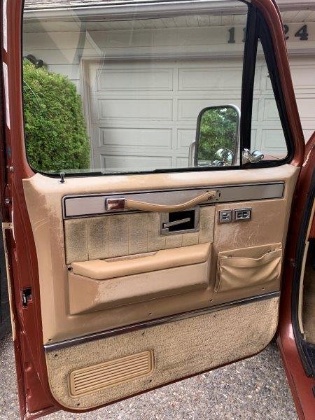

I took a few pictures of the underbody and interior for you guys to see. It’s a very clean northwest truck with *minimal* rust. There is a dent on the driver door a small ding on the rear of the cab and some other small scuffs.
They sell conversion kits to make it a R134a truck for the AC because R12 isn't exactly around anymore.

So I've been told. I think I'm going to just leave it as is. The AC isnt a big deal for me we literally get two weeks of summer where I'm from!
