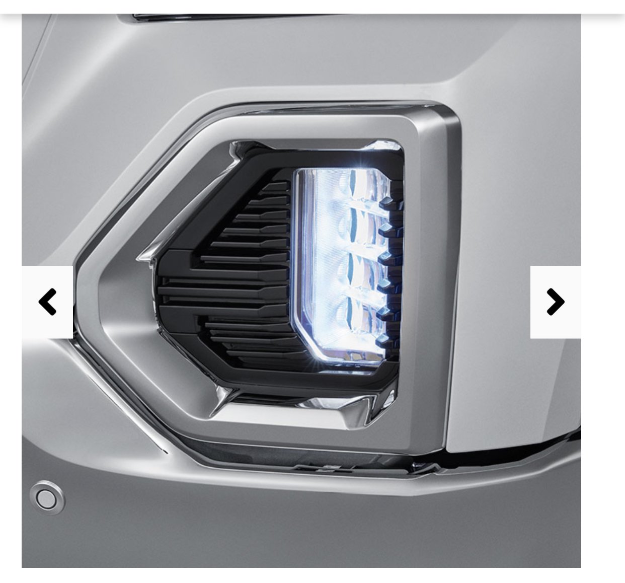

I am new to the Sierra family, just picked up a 20 Sierra SLE 1500 and enjoying the truck so far. Looking forward to learning from everyone here on the forum. I have a few mods in mind but want to start with fog light installation. I noticed the higher end trims have a different bumper cover with a different part number that allows for the trim bezel piece insert, does anyone know if these parts are interchangeable, the SLE does not come with fog lights or the bezel/clip and I want to add this to the look of my truck, if I were to obtain the SLT, Denali, or AT4 bumper cover would it fit on my truck that way I can have the fog light trim bezel?

Thanks for the response, however I was hoping to get information on the silver trim ring around the fog lights. The higher trims have inserts in the bumper cover that the trim ring attaches to. Is there any info on the bumper recovers being universal to all 1500 models?
You would need the plastic upper bumper from the SLT+. Then you could get the trim pieces you are looking for. I think the fog lights are probably the same with just different surrounds.
It's interchangeable. Just a matter of getting the required parts and paint work. Here's some of the parts required not including the wiring, switch, and dealer programming to make them functional.
I installed the gm accessory fog kit shown above on my sle. But used a harness from gen5diy.com that doesn't require dealer programming.
