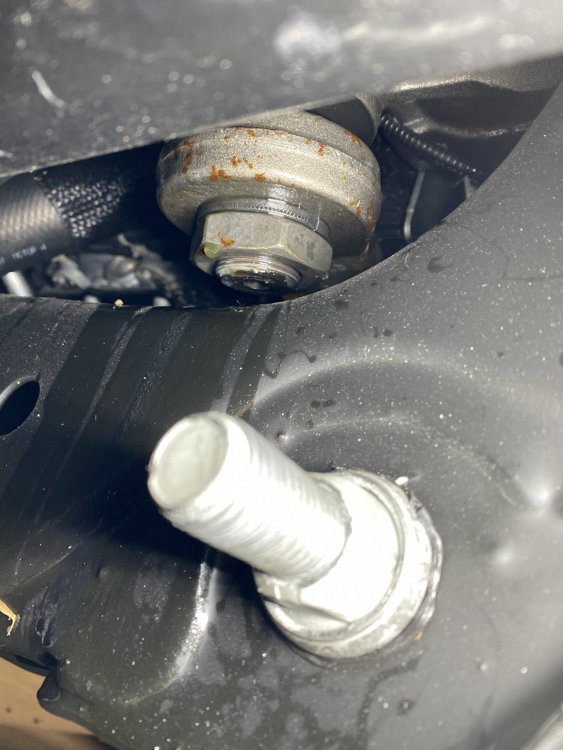

Brought my new 2020 gmc 2500 SLT  Duramax home from the dealer and found a puddle of oil underneath the next morning. Took it to the dealer and they said it was the power steering booster. Replaced the whole unit and gasket. Picked it up in the morning and by the evening it was leaking from the same spot. Anyone have a similar issue. Dealer said it’s the first one they have seen. Sucks to have a truck at the dealer with 150mi on it, owned it for almost two weeks and only driven it for 2 days.

Mine leaked last winter....but I live in Alaska and it was -30s/-40s. Replaced the gear box then the replaced the pressure line and had it arctic modded by a shop up here, not the ones GM sells.
