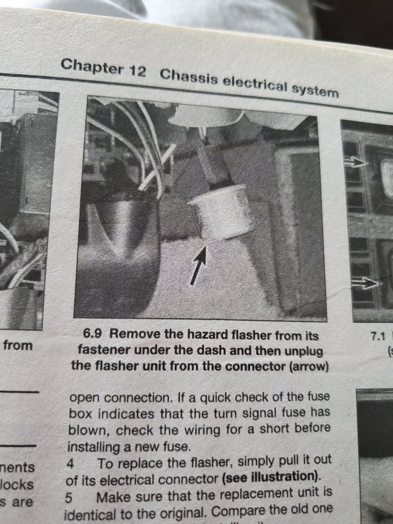

Underside of the column. Push the centre in to activate and pull the collar out to deactivate.
flasher in under dash left side of truck on inside of firewall , looks kind of like a fuse box but just has relays on it
Sorry it was early in the morning and I read that wrong. Thought you were looking for the switch. The hazard flasher is right at the bottom of the dash around the steering column on the 88-94 trucks.
The fuse box Brian is referring to houses the turn signal flasher.
