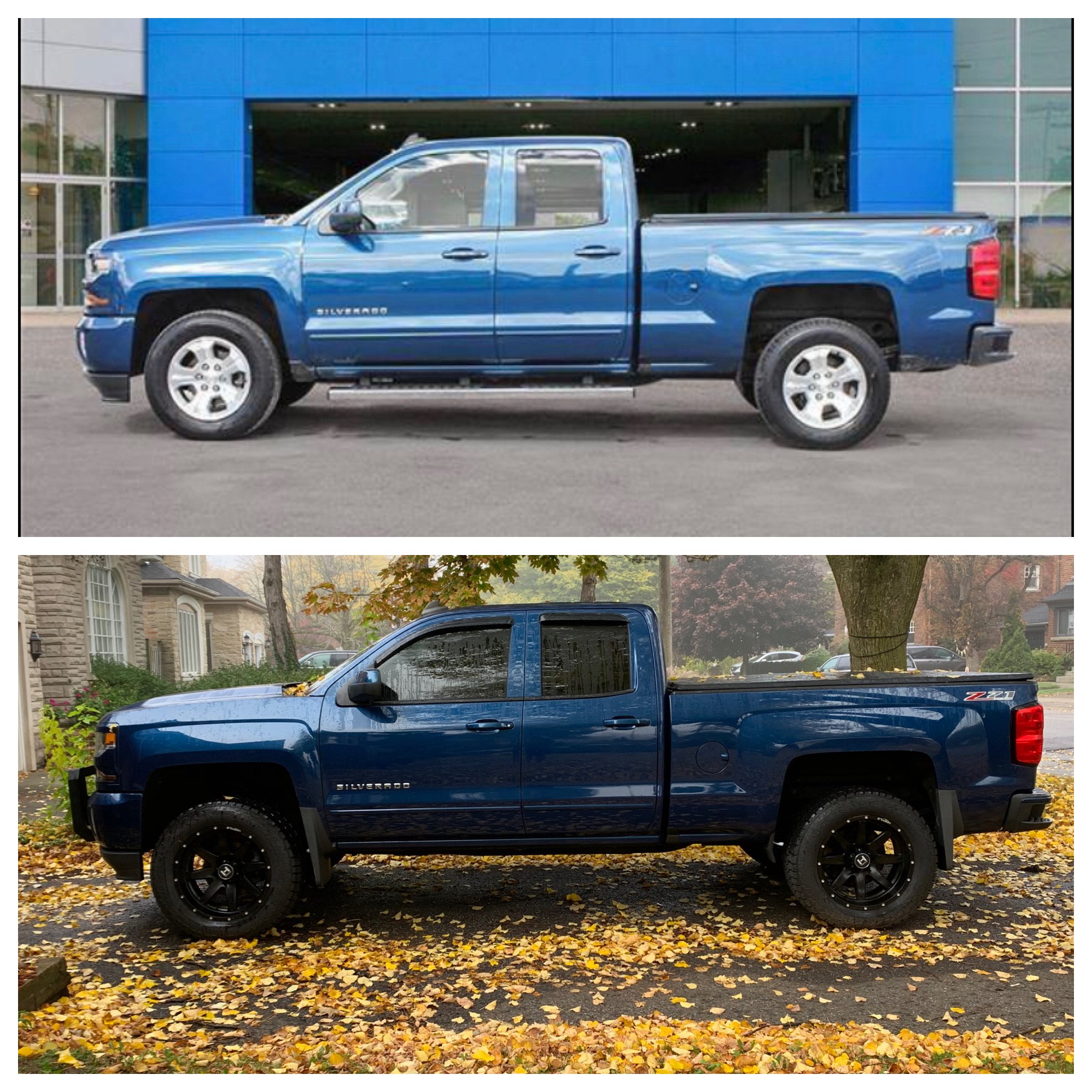

Here's a quick before / after shot of as it stands now..
