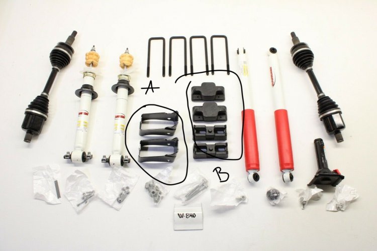

I've been posting here a bit about getting the 2 inch lift.  I'm trying to understand what I'm getting, learn the different parts, etc.
I'm having trouble understanding what Part A is and where it goes?
Also, Part B are the lift blocks for the back, but why split in two?  Is it one between the leaf springs and the other goes below the rear axle to secure it or?
Thanks in advance for your time.
Edited by SilveradoRST
13 minutes ago, lapoolboy said:
"A" are the front frame horn relocate brackets.
"B" are the rear lift blocks and bump stop extension pads.
Thank-you!!!
What does the front frame horn relocate brackets do?  Since the frame horn is up at the front right behind the bumper (right?) is to reinforce that piece?
I tried to google the instructions, didn't have much luck.  Lots of instructions for other brands, but not the GM lift.
Would like to know what those frame horn relocation brackets do as well.
My theory is it's just for crash standards to keep the impact height the same.
And you'd be absolutely correct.
