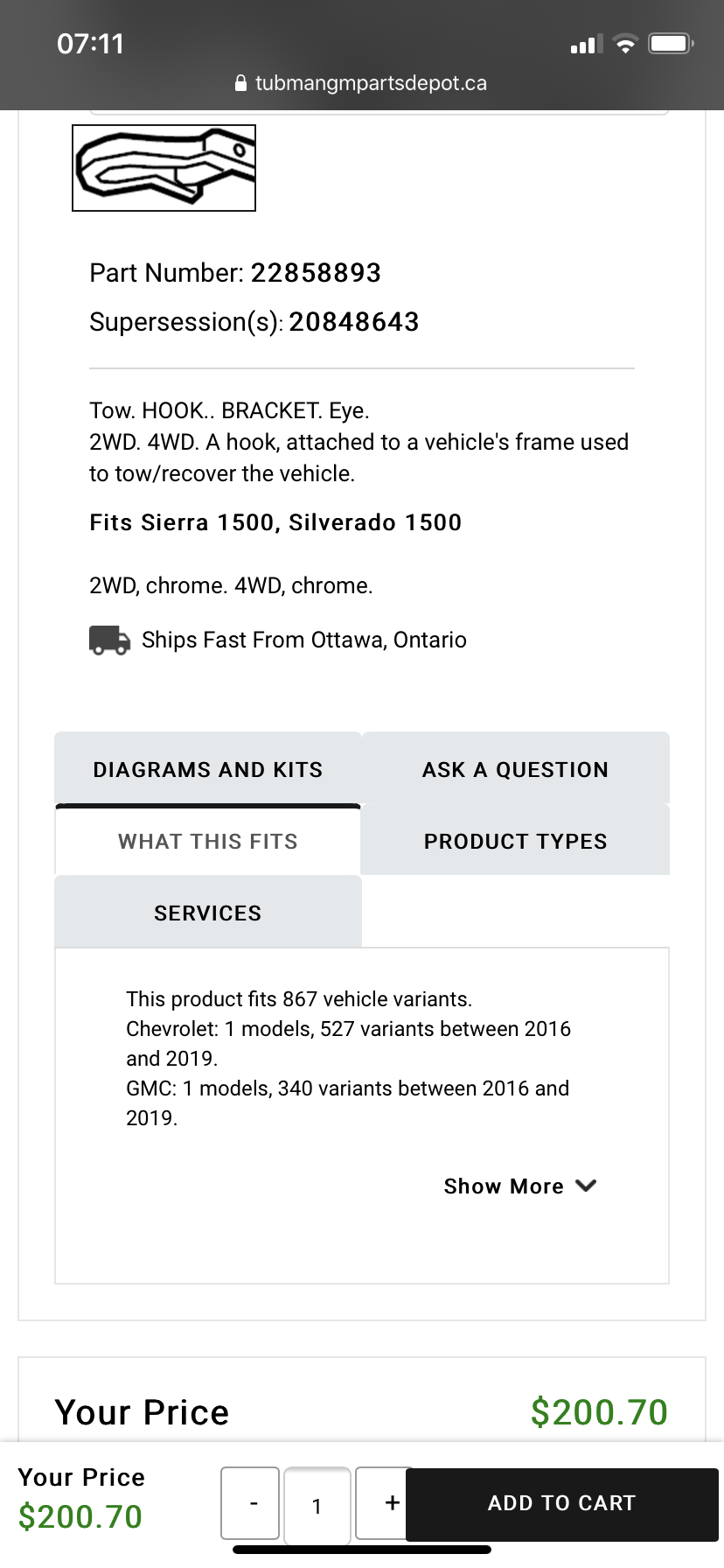

While searching for a set of shackle attachment points that replace the front tow hooks on my 2017. I am wondering what ones from Rough Country would fit.
Is there a big difference between the 07-13 and 19-20 model years at the frame horns?
Found this company that sells a style of tow hooks that bolt up on 07-19 model years( see pics).
If this tow point can accommodate from 07 until 19 model years. Shouldn’t the shackle attachment from RC for 07-13 or 19-20 model year fit on a 2017 ?

One would think... You could check part numbers on oe tow hooks. Should list what applications it will work on.
Didn’t think about doing that. Thanks for the tip
From M1Ck3y’s suggestion. It looks like the tow hooks for a 16-19 are compatible.
so looks like the tow hooks from RC for the 2019 will work.
