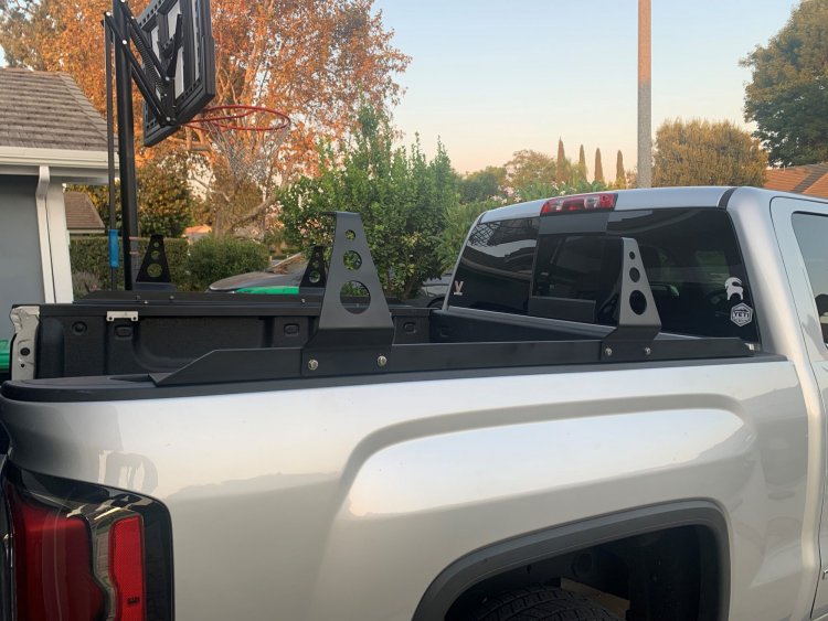

The price of the bedracks are ridiculous these days. I ended up going the DIY route. Just angle iron, lateral supports from compact camping concepts. Everything came under $250. Fits my stock tri-fold, which takes up a lot of room on  the rails. Some drilling is involved.

I got the unfinished ones and then painted them myself. I was in a hurry for a trip to Zion so had to throw it together quickly. If I had more time and money, I'd get everything powder coated or use bedliner spray on them. I got the cross bar (square 1.25") and angle iron for a local metal shop. Then I found comparable from Home Depot for cheaper! I went with 2" angle iron, which is overkill.
That looks really good. Im looking at Putco right now, I heard a number of $1600.00 installed. [emoji53]
Sent from my SM-N975U using Tapatalk
Thanks! I was looking at some of the super high end ones and loved how they looked so rugged. Then decided just to go the DIY route and spend the money elsewhere. I must say I have received numerous complements from people looking for racks. From those who already have pre-fab racks I get nothing but stares and hate ?
