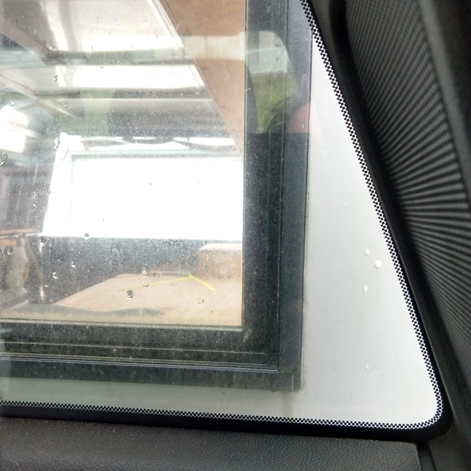

Thanks for the reply.  I finally removed and installed a pass thru to the cap.
Before and after pictures attached.
Excuse the long delay in replying.

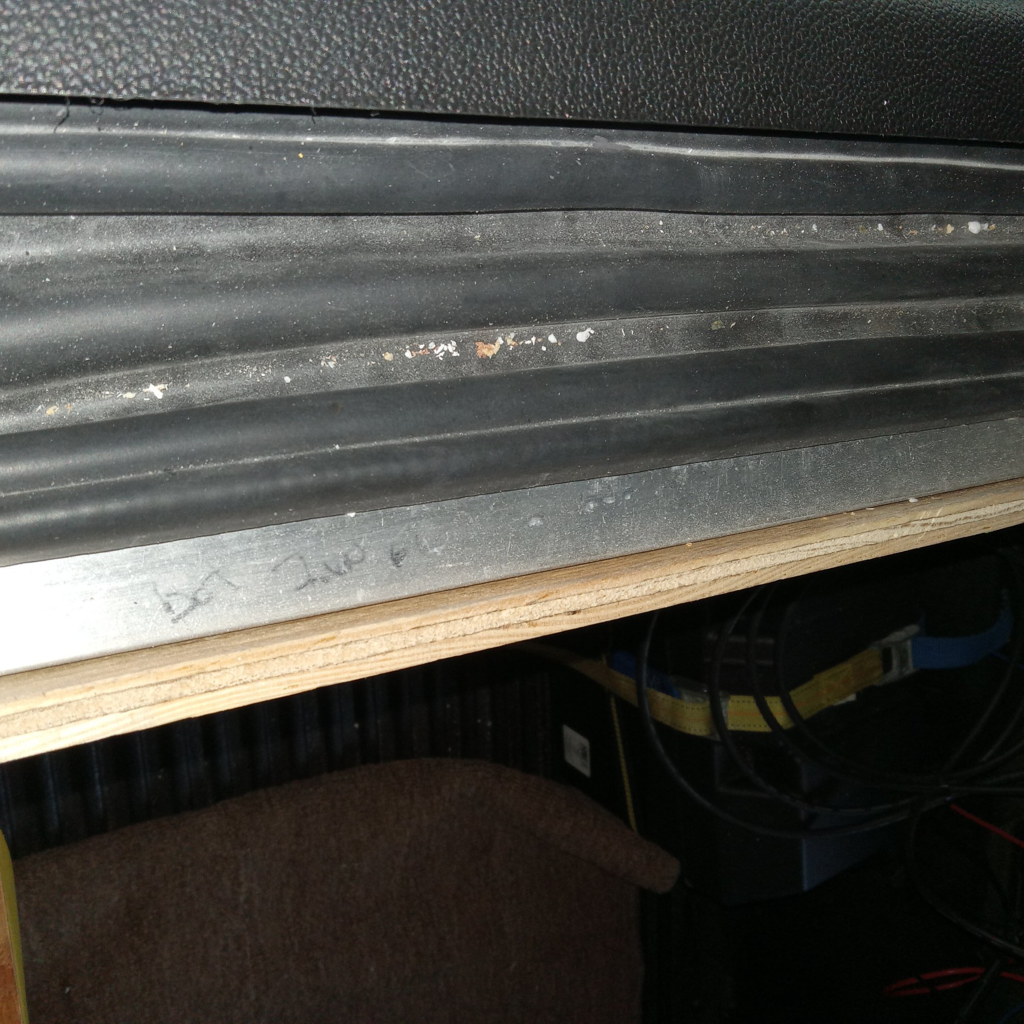

Hello:  Worked fine enough.  It would work fine for my dogs.  The picture below shows the added flange (flat stock aluminum) used to meet the lower edge of the cab's flange.  That worked fine.  The bed cap needed one 1" tubing removed and then cut to form the top half that would match the cab flange.    I wasn't expecting anything aesthetically pleasing on the inside. I used the plywood along with a hinged door (I can't locate that picture) to close off the opening if I should want it quieter in the cab or privacy in the bed (truck bed happens to have a cot to rest on).
It works for me, but it will never be the van I wanted.

Hello:  Worked fine enough.  It's fine for dogs.  The picture below shows the added flange (flat stock aluminum) used to meet the lower edge of the cab's flange.  That worked fine.  The bed cap needed one 1" tubing removed and then cut to form the top half that would match the cab flange.  I'll see if I can find that picture.  I wasnt going for anything aesthetically pleasing on the inside. I used the plywood (edge can be seen below) along with a hinged door to close off the opening if I should want it quieter in the cab or privacy in the bed (truck bed happens to have a cot to rest on).
