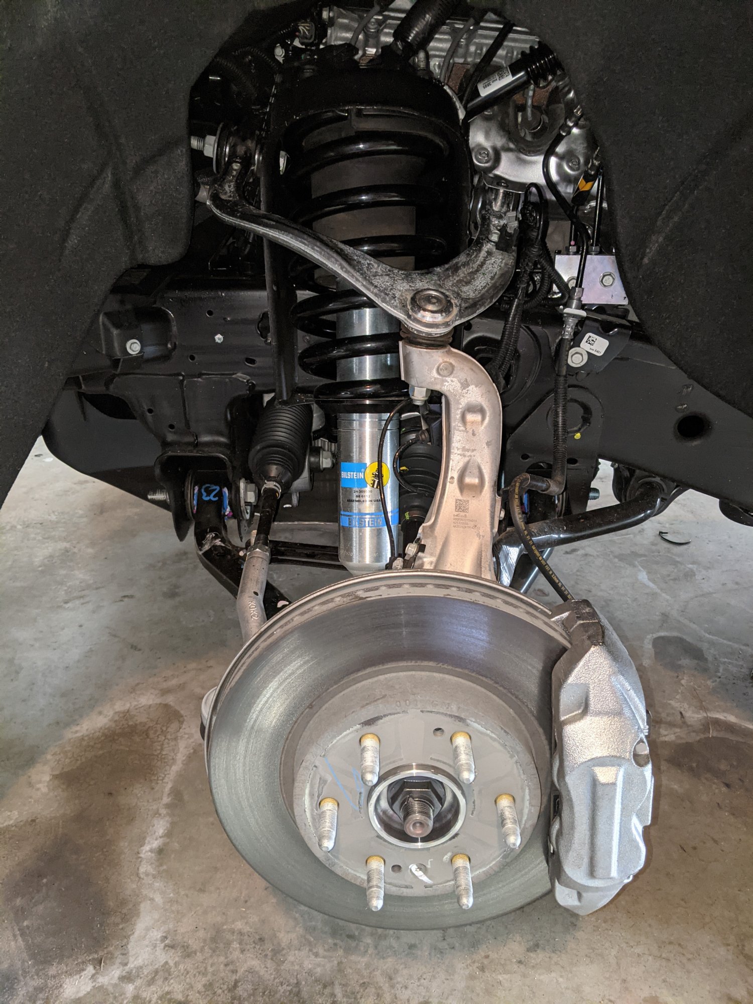

I'll just leave this right here...
Bilstein 6112 for TB/AT4.  Set on highest clip to bring front up 1.2" for a total of 3.2" up front....levels the truck nicely.

Where did you buy it? Model number? I am more into coilover setup over lift pucks.
B ut your axel angles will still be out of wack and the upper control arm is not happy (ball joint)
The axle and ball joint angles are no more "out of whack" than they were when stock.  The suspension can only travel through a specific range of motion bound by its physical limits; i.e. UCA droop stops and bump stops.  Most trucks won't even see these two extreme ends of the articulation angles during normal operation, everything else is within the same range of motion as the stock setup.  The axles and ball joints are engineered to function properly within these parameters and have plenty of margin built-in.  If you put the truck on a lift and take the front struts off, you can cycle the suspension from total droop to total compression with a physical "stop" at each end.  The ball joints and axles are designed to work inside this envelope (plus a little margin each way for reliability).  This doesn't change simply by adding an aftermarket lift strut.  Limits are just that.
I'm fairly certain one of the biggest names in suspensions - Bilstein - knows this as well.  That's probably why they have no problem putting out a product, with warranty, that lifts the front of my truck 1.2".
