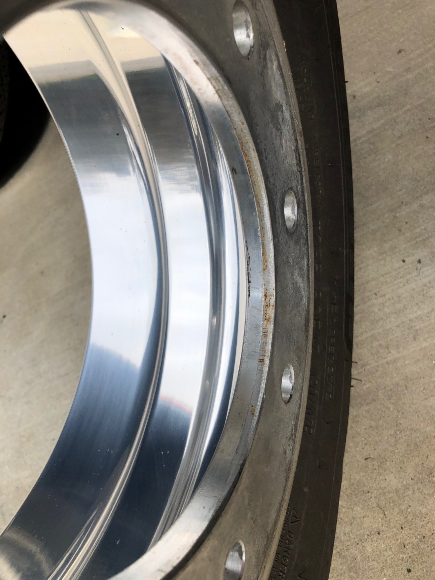

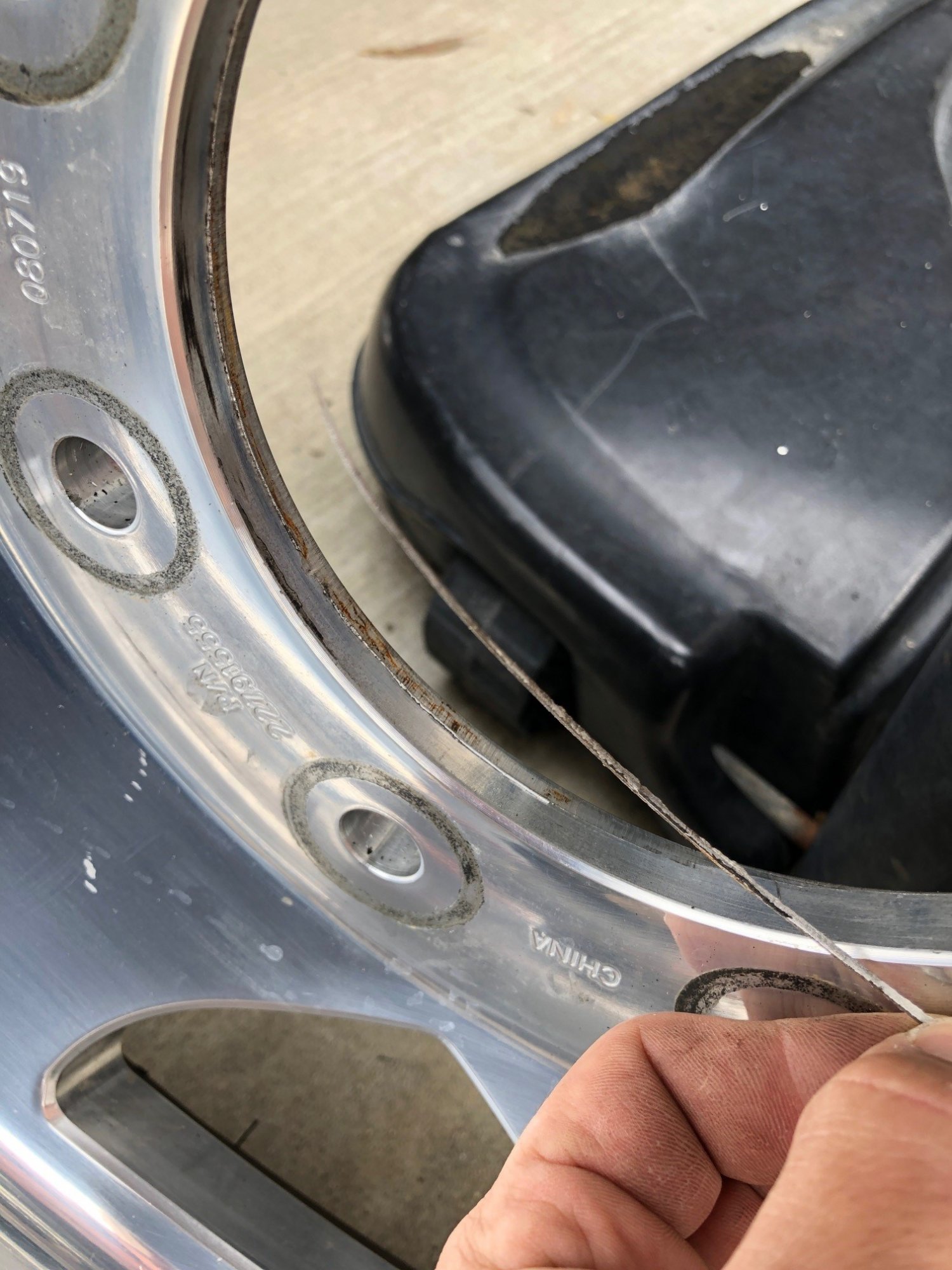

Discovered 2 new issues today resulting from that same visit. I am heading out with the fifth wheel tomorrow, and I needed to add a few pounds of air to the tires. Guess what?  DumbA$$ mechanic clocked the rear wheels, so I could not access the inner valve stem.
I discovered the second issue when I pulled the wheels to correct. DRW rears take a bit of patience and care to get on correctly. This guy had 0. He must have used a damn impact to flush them up and pinched both outer aluminum wheels as they went on crooked. Passenger side was worst - pictures attached. You can see the strip of aluminum in my hand that came out with the wheel.  Gave my advisor an earful, and they will replace my rims if I ask them to. Don' think this will cause any future issues, but I may tell them to put the new rims in the queue for when I need tires.
