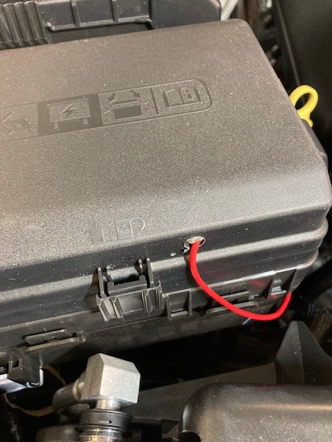

The photographs below show how I picked up power for my front camera by tapping into position 40 in the under hood fuse box on my Silverado Custom.  I ordered the tap from Amazon.  Using a ten amp fuse, it has worked fine with no problems
