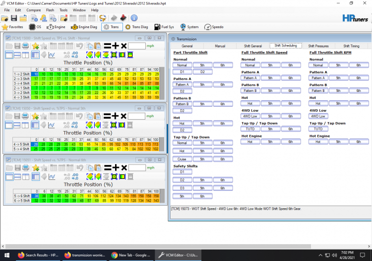

Here is a break down of shift speeds based on throttle percent and vehicle speed for a 2012 Silverado with a 5.3/6L80e and 3.42 gears.
Only a tune can change the the vehicle speed that is shifts at. I usually end up putting 6th gear at 50mph and 5th gear at 45mph.
