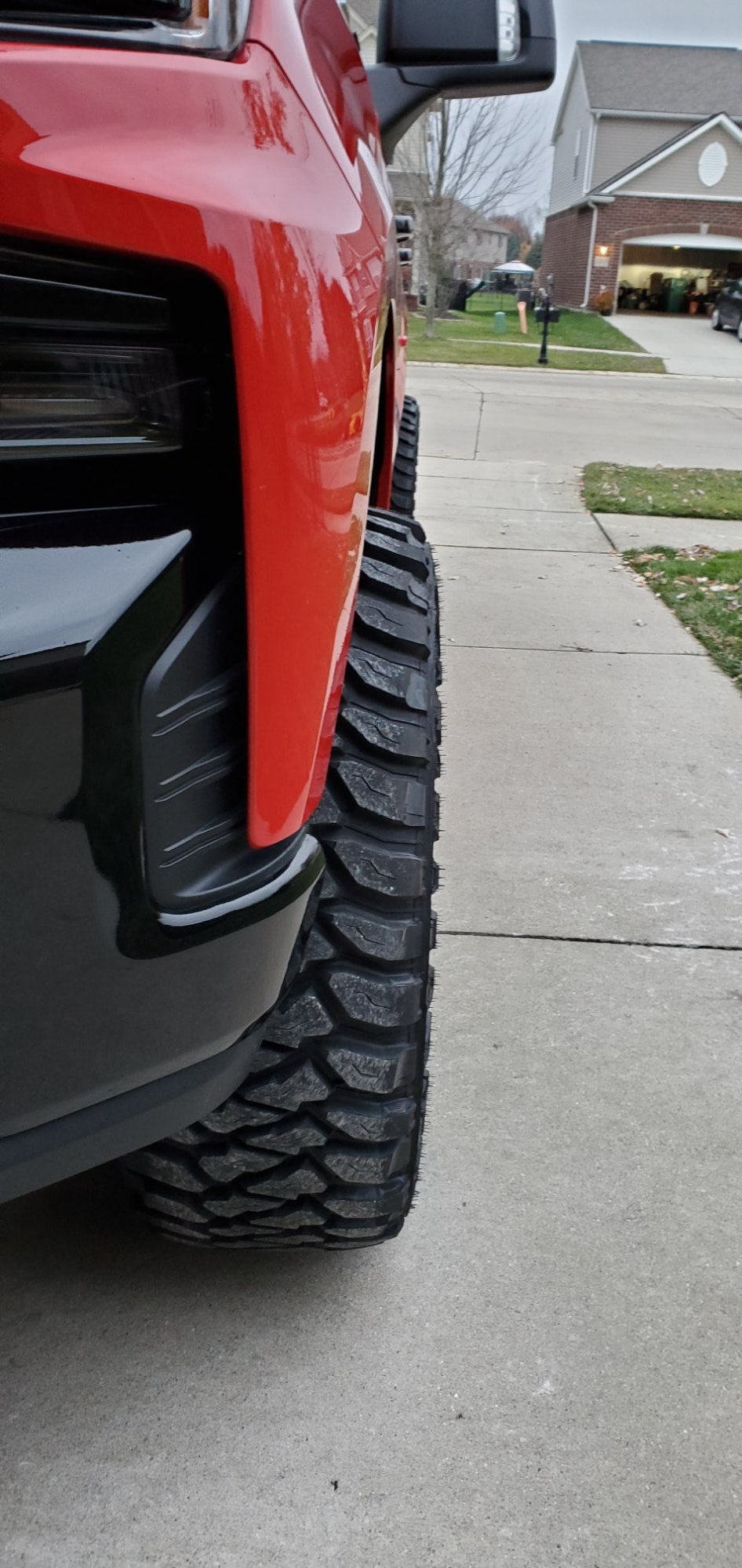

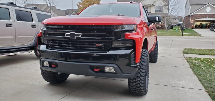

I am using 1.5 inch spacers on a 20x9 rim with 0mm offset.
Edited by z1boss
7 minutes ago, curtcab said:
Wow! That looks great, any rubbing at all?
Very very minimal, I had to trim the inner (unseen) mud flap and remove the bracket behind it but not too hard.
36 minutes ago, It's Tim said:
How often do you plan to replace wheel bearings? MIght not be a terrible idea to keep a few in the truck.
I dont expect to replace them until they are worn out due to normal wear and tear.  If I have to guess, 120-150k miles.  I have almost 60k miles on my 2019 right now and have zero issues with the wheel bearings.  The spacers do not really affect them
Beautiful, I’m going to try to get the same size spacers. What size tires are you running? Thank you
Awesome, thank you again! I really appreciate it.
