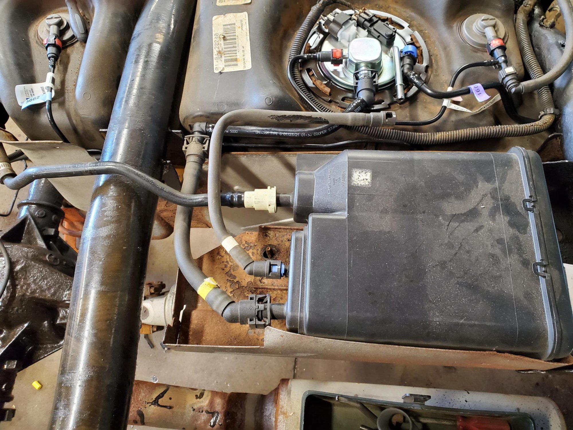

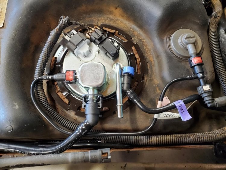

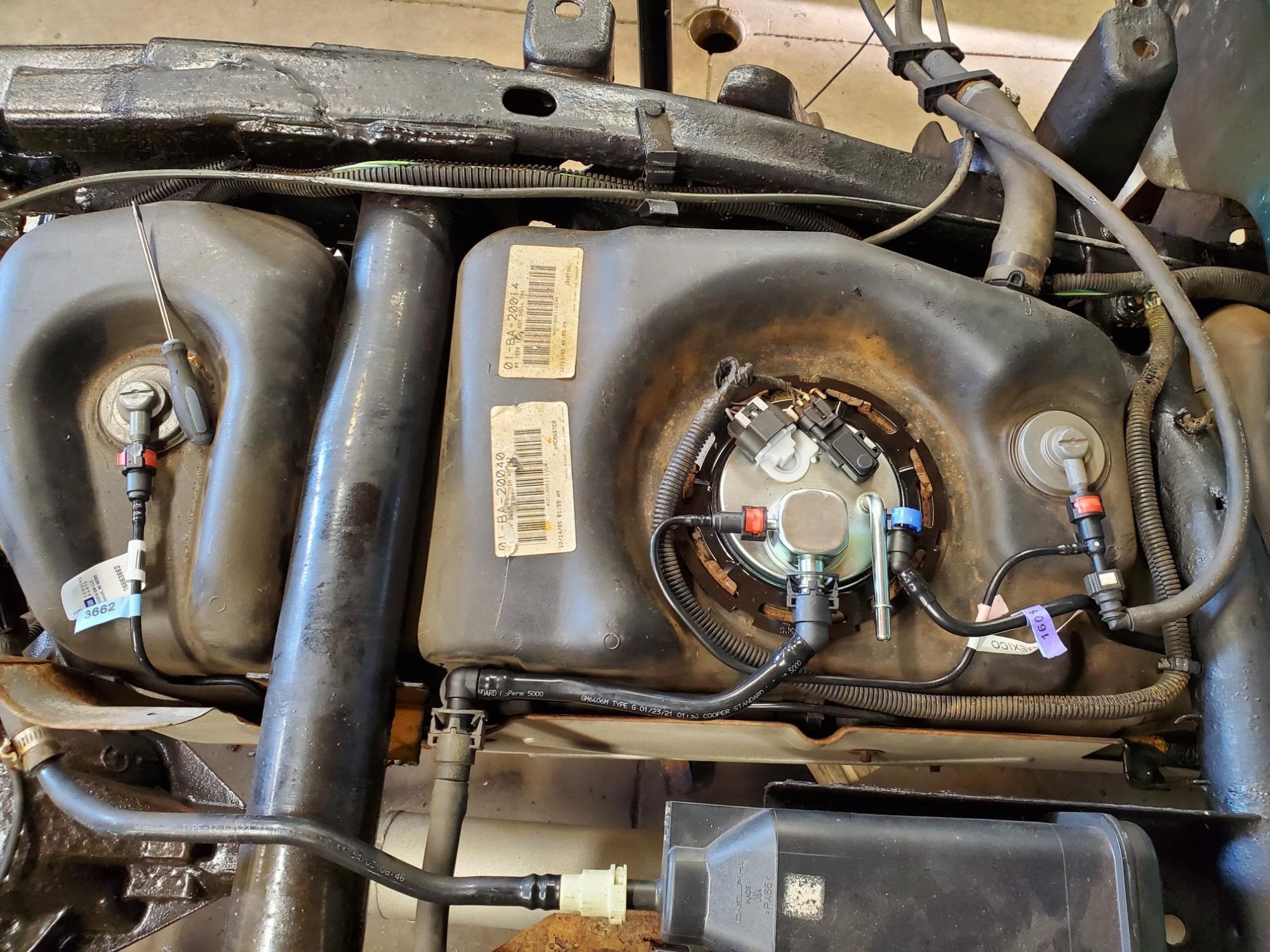

Had to uninstall Fuel tank & EVAP Cannister for frame repairs. Ordered new fuel complete sending unit, 2 new lines for fuel tank & 2 new lines for EVAP system. Having issues during the re-install of fuel tank & EVAP cannister. I'm unable to find a good diagram showing hose routing. FYI, EVAP cannister is mounted on front frame support laying flat under bed. Need help with hose routing. Attached is what has been installed. Please!!!
Does the new sending unit EXACTLY match the older one you removed? I ask because it looks like you got an what was an original hose (it's dirty)  but now it don't match up to the sending unit, it doesn't bent over to meet that nipple that's on the sending unit. So that's why I wonder if the new unit is "fits most" instead of fits YOUR application. GM has this info (hose routing) in (an assembly manual for sure) publications, the local dealer might run off a copy (from the exploded view in the parts manual) for you, heck pay 'em if they ask....Otherwise you can check the bone yards around your location, ask other guys with the same truck, they might know....
