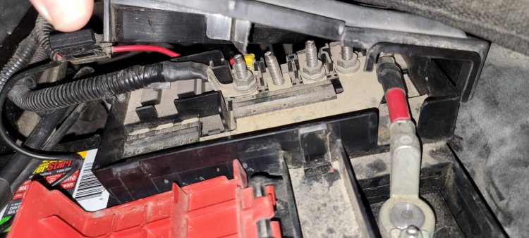

On 8/25/2021 at 5:47 PM, Frankielozano214 said:
Try changing the top piece above the battery that has the top terminals, I accidentally connected the jumper cables in wrong spot on my alternator and it fried that piece lucky I had a spare. Had all type of codes and no power steering, no Ac, Cluster was flashing turning off and on, window didn’t roll down either 😂 I thought I really messed it up but it was a easy fix swapped the battery and that top piece. I’ll see if I have the pictures of it. Each one of them top terminals are like fuses they can burn out and the truck won’t work depending which terminal is burnt. Mine happened to be the one that controlled everything
I have one of those missing a nut? Truck is having all kinds of crazy issues for the last 4 months
Did u put a nut on it? Did it fix your issue?
Might wanna get a tester and test each stud make sure they are still good before replace if, those are fuses so might have to buy the whole top piece if it doesn’t fix your issue,
