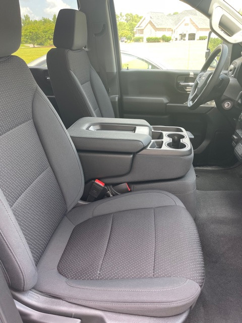

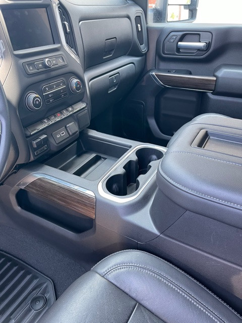

The seats and console swap took almost 3 hours. My truck did not have a plug for the full console harness, so it is unplugged for now. I bought the interior set from a local junkyard. Set was both front chairs, rear bench seats, full console, and 4 door panels. Door panels swap is pending. The driver seat is now power adjustable. Surprisingly was plug n play, no additional wiring needed.
Donor truck: 2019 Silverado 1500 RST crew cab
My truck: 2021 Silverado 2500 Custom crew cab
Only issues were a gap between full console and dash, rear doors need a longer lock wire rod and additional mount hole, and no power to USB connections in full console. The trim panel for gap is part# 84127263. The 2500 lock wire rod needs to be lengthened by 3 inches to work with 1500 rear door panels. The 2500 rear door top trim will require a small mount hole to accept a push mount tab on 1500 door panel.
Before
front
rear
After
front1
front2
rear

For the gap under the console, on trucks built with a console there is a trim piece that snaps in there.
See the YouTube at 2:53
Others that have swapped in the console may chime in.
Looks great!
That's the part. Looks like I will need to move the console to install it.
