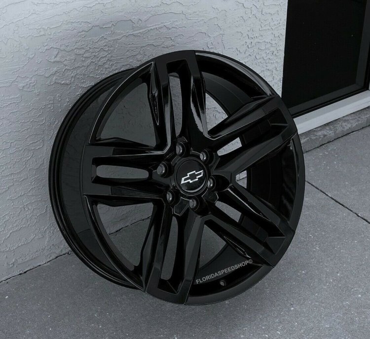

I want to put 18" trail boss wheels on my 2018 Silverado LTZ which has 22's on it currently . The Trail Bosses come stock 275/65/18 and I would like to go up to 275/70/18, would these wheels and tires fit my 2018 truck?  It seems to the same bolt pattern, just want to confirm before I purchase them.
Wheels will fit. But you will want at least 2" level to fit the tires. I have 275/70/18's on my truck with 2.5 level in front
Thanks for the reply, I have a 2" level as of know, think ill be good?
I had 275/70r18 on stock 18’s on my 16 1500, rubbed pretty bad with no level, put 2.5” level on and no rub at all. Did rub on motofab upper control arms though
