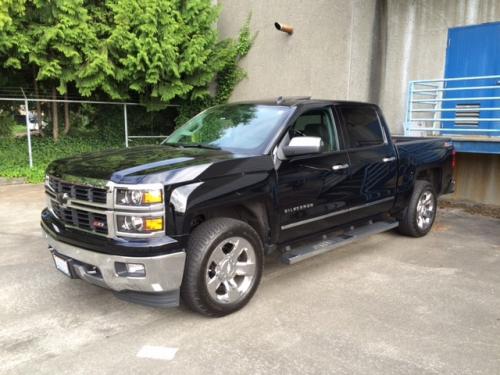

Off topic, but this was my loaded up LTZ Z71. 6.2, 6 speed with a 3.42 in the rear. This was a fun truck on the freeway onramps.

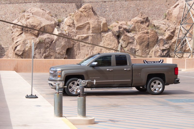

Very Nice I like the black. Mine is the 5.3 with the 6 speed. I am not sure of the axle ratio. I have not looked up the RPO codes. But I love it. It drives very nice and has decent power and economy.
My Fast one is my 69 Mustang "Mistress". My Wife Named Her. :)

Very nice pair, 69 and 70 are the best looking years for the Mustangs. Great looking truck too!!!
