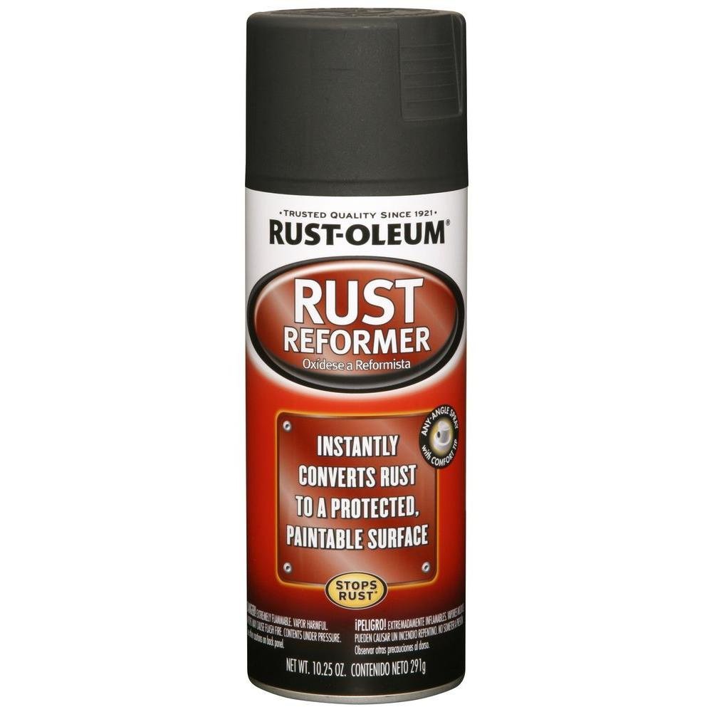

If it was mine....Powerwash it to get the dirt off and spray everything with Rust Reformer
