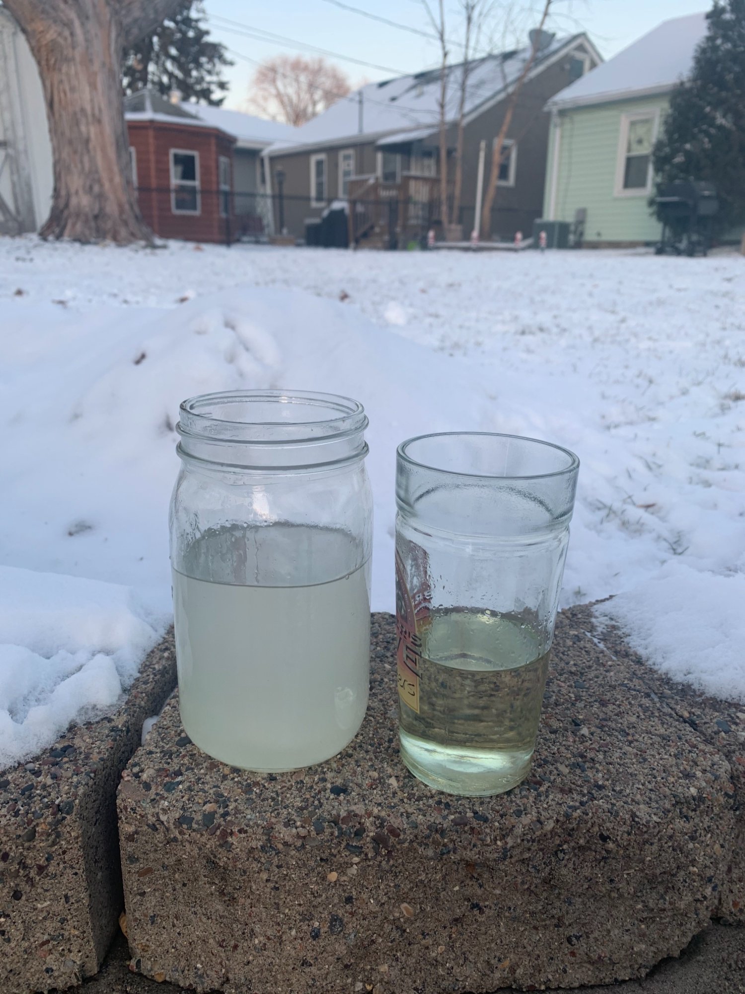

The jar came out of the truck , the glass on the right is year old gas for the snow blower from last year . The new gas ( 20 gals ) was what i topped off with and had to drain . Truck is back to normal .
that will do it! NEVER buy gas when they are refilling the tanks, it stirs up any water or crud in the tanks and most dispensers/ pumps don't have filters. almost ALL storage tanks have some water in them
