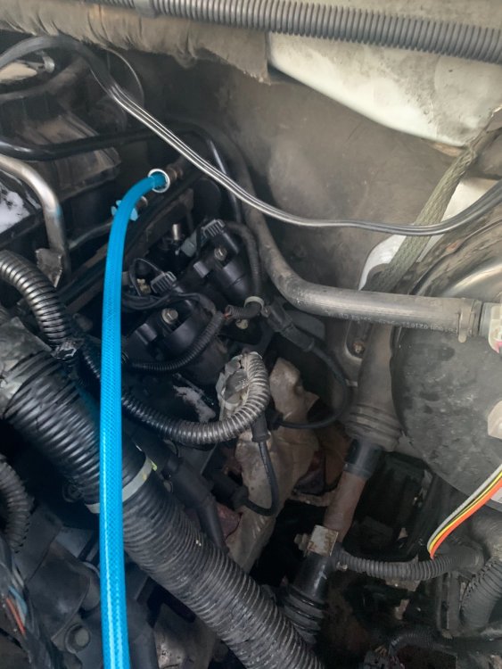

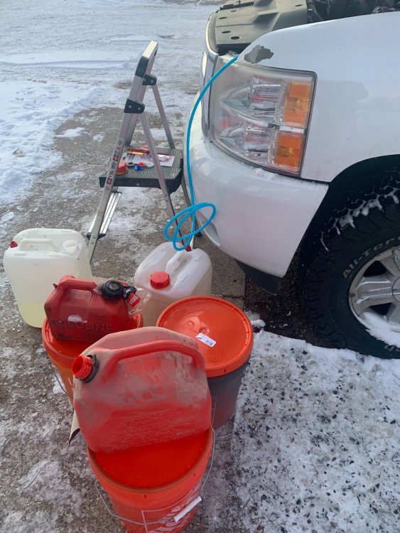

My Silverado ( 5.3 ) fires but won't catch and run . I replaced the MAF , The TPS , the ignition switch . I checked No.1 and No.7 plugs their not fouled . The fuel rail has gas i checked 3 different times and pressure seems consistent .
I tried cycling the key 3-4 times to build fuel pressure but didn't mame a difference . The fuel shoots 1-2" in the air each time i check the fuel rail for pressure / gas

The day before 50 deg's ran fine
the next day 12 deg's let it warm
up , filled the tank Nd noticed a miss and super sluggish and stop lights and signs but would clear out and run fine over 1000 RPM's driving .
I agree and am getting my Azzz handed to me with this one . If my fuel rail is full it should run 10-20 sec's and then run out of gas . Thats not what happens . The fuel rail valve shoots fuel 1-2" high consistently so the pressure is in the rail and should be weaker if the pump Is failing or not keeping up .
1-2" is probably not enuff. put a gauge on it, should be over 50 psi. auto part stores have the gauges in their loaner program if you don't have 1
