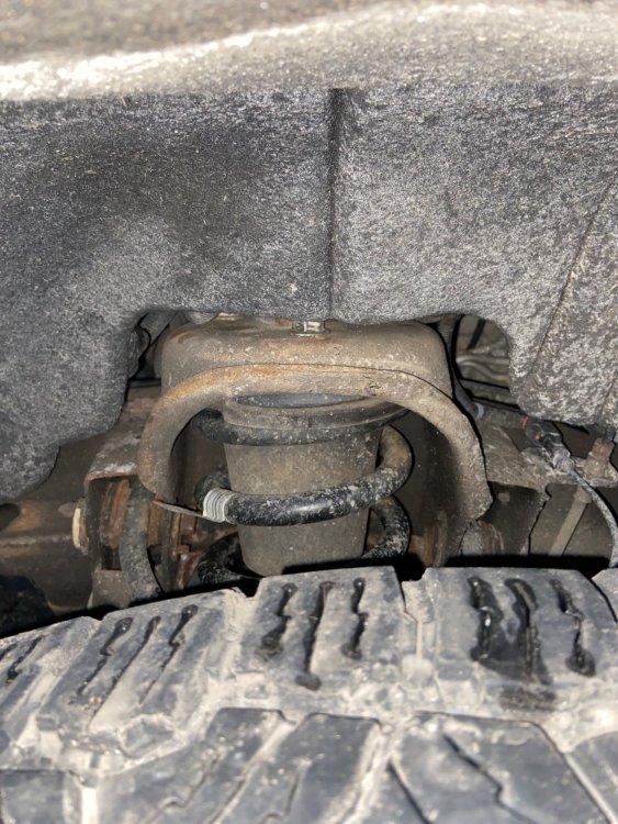

I’ve recently replaced my shocks all around with bilstein 4600’s. I’m wondering if I reinstalled the struts correctly? Ive read that the end of the spring should face outward, however mine are in different locations either side of the truck. I recall the 3 upper strut bolts only fitting one way, and I had to turn the shock body to line up with the lower bolt holes. I don’t believe I have the struts put together wrong, they’re both seated tight against the top aswell. Truck is a 2015 Silverado z71.
I can’t seem to wrap my head around why it would even matter what orientation they’re in with regards to the spring ends facing a particular way. But i could be wrong. Probably just my ocd bothering me.
Ive attached a couple pictures.
/cdn-cgi/image/format=auto,onerror=redirect,width=1920,height=1920,fit=scale-down/https://www.silveradosierra.com/attachments/2390ba8f-7c7e-4d2a-a656-20dcc0d6052c-jpeg.944192/
Thanks for any help!
Nick

As long as the strut bolted down on the bottom correctly, it doesn't matter. I just know that on the bottom you can have it turned the wrong way as the angle would be wrong, I just spin them around until it does line up when I do struts. Never had a problem.
